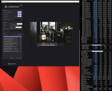

IT would be above 170w if you had it DELID with diamond cpu-waterblock, underground salt water reservoir at -3C, with premium industrial heathing pumps, heatexchangers, two car radiators. According to some people. :tearsofjoy::tearsofjoy:
I actually have a sort of car radiator (Bykski B-RD1080-TK-V2 in addition to two 360 rads) and i use LM instead of paste, but it wouldn't probably go above much this amount of watts even with delid because it's mostly voltage limited, not thermally limited. Of course, there is something that prevents proper heat transfer with x3d cores (just compare temps on my highest score screenshot), but even with that CPU could probably do more (normal z4 can do 5.5 ghz all core with 1.25v ish even without delid)

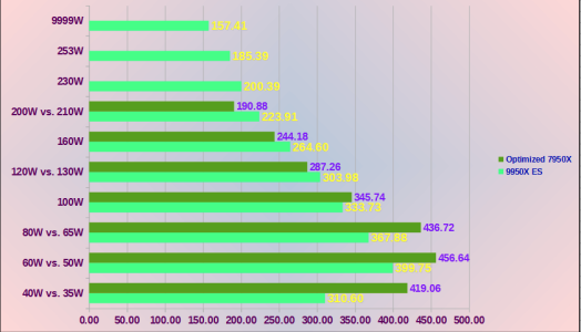

Perf/watt comparison 9950X ES vs. Det0x's optimized 7950X
Det0x's data source: https://forums.anandtech.com/thread...ranite-ridge-ryzen-9000.2607350/post-41255152
Past 100W, 7950X can't compete on perf/watt in this benchmark and basically game over after 210W PPT. But it does show that if you are allergic to watts, 7950X will offer you better performance for your electricity bill at lower power levels.

Think we will need a proper V/F curve for 16core Zen5 before we can draw any final conclusions in regards to the comparison above..
Dont think the V/F curve for the 9550X ES is optimized/finalized at the lower end of the spectrum (sub 160w)
After i get a retail 9950X in my hands, i can do a real apples to apples comparison

True but it will be very surprising if the retail sample does well at the lower power levels.
Your ES is fed with the right cores voltages but the VRMs voltage is kept at a fixed value whatever the cores effective voltage.
This way the CPU integrated regulators have very low efficency at lower cores voltage since their voltage drop is uselessly high, with a proper implementation the VRMs voltages will be reduced to lower values with the ES when the cores are fed with a very low voltage, as to get the integrated regulators voltage drop at an adapted value.

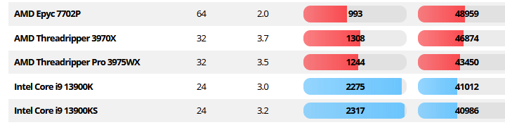

48K @300W is insane, hopefully the temps are much easier to handle this gen.
Bit less efficient than a monster 128 thread 7702P but hey, it's almost delivering similar perf with 4x fewer threads!

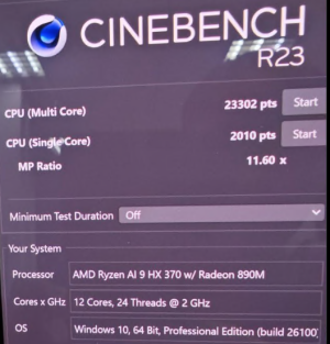

After doing some math I would say this is basically full throttle for strix, so more a score of a potential Desktop SKU where TDP is no limit.
How I got to this conclusion:
8700G has ~18k in multi, 1833 in single according to CPU monkey. 1833×8×1.25(for SMT) = 18330. Fits quite well, so I just assume 8700G is able to run allcore on specified Boost.
If we do this for Strix we get: 2010×4×1.25= 10.050 for ZEN5
1460(3.7GHz Boost for ZEN5c according to David Huang)×8×1.25 = 14.580
So I get 24.600 as max value strix can theoretically achieve, 8700G was 1.5-2% higher than reality so I would say 24.400 is the max points strix can achieve.
Cutdown strix: ~19600 points with same measurement.
