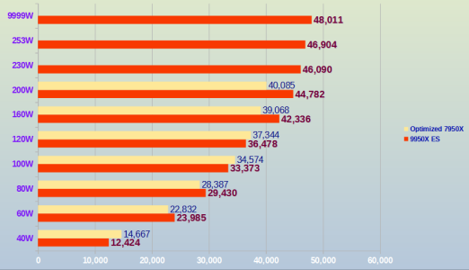

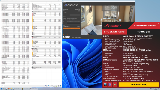

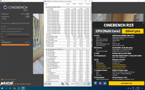

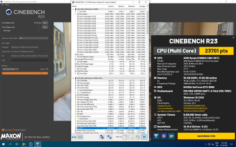

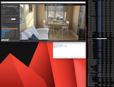

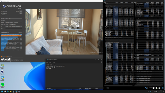

Hold on, i found my old power/performance screens for the 5950X :cool:
(highly min/maxed in cold norwegian winter-air 😇)
16 Zen3 cores @ 49 watt = 20441 points in Cinebench r23 (~lowest powerlevel i could run with my old setup)
16 Zen3 cores @ 64 watt = 23701 points in Cinebench r23
16 Zen3 cores @ 88 watt = 27037 points in Cinebench r23

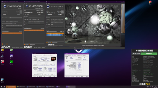

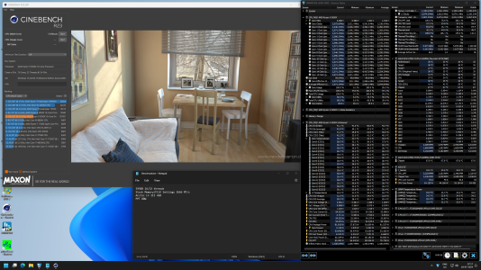

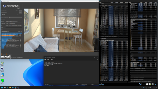

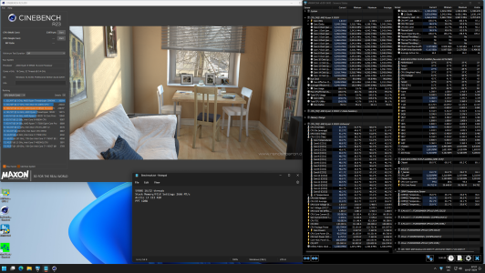

And if that was not enough, i even found optimized runs with my 7950X 🤣
PPT 35w, 60A TDC and 120A EDC limit = 14667 points
PPT 50w, 65A TDC and 125A EDC limit = 22832 points
PPT 65w, 70A TDC and 130A EDC limit = 28387 points
PPT 100w, 80A TDC and 150A EDC limit = 34574 points
PPT 130w, 100A TDC and 160A EDC limit = 37344 points
PPT 160w, 115A TDC and 175A EDC limit = 39068 points
PPT 210w, 140A TDC and 200A EDC limit = 40085 points (OBS: CPU only pulled 204w maximum)
All the runs above are highly min/maxed for Cinebench r23 power/performance, so i'm not sure if its wise/fair to add them (probably but not fully stable for daily usage)

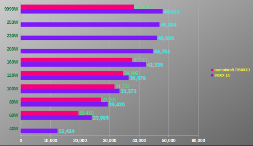

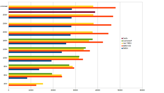

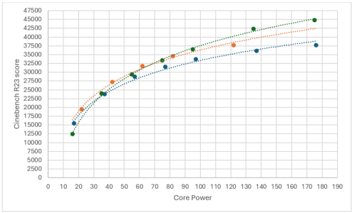

Green is 9950x
Blue is 7950x
Orange is 7950X3D
Compared to Zen 4, (using the 7950x), Zen 5 sees a ~5% perf/watt at ~3 watts, ~10% at ~4 watts, at 15% at ~6 watts per core.
Turin is prob going to end up using ~3 watts per core.
Any word yet on the Zen 5 silicon for consumers? I know it's N4 something. Did anybody find out if it's N4 or N4P. I doubt that it would be N4X.

Green is 9950x
Blue is 7950x
Orange is 7950X3D
This is modeled off of the really high scoring ES with the extreme cooling setup?
Would be curious to see this when a mainstream review outlet gets a hold of the 9950X.

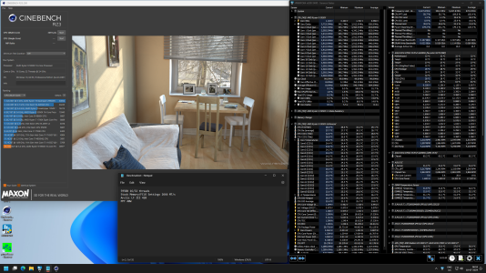

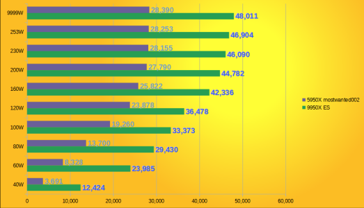

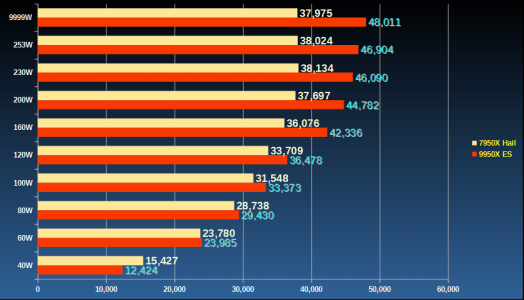

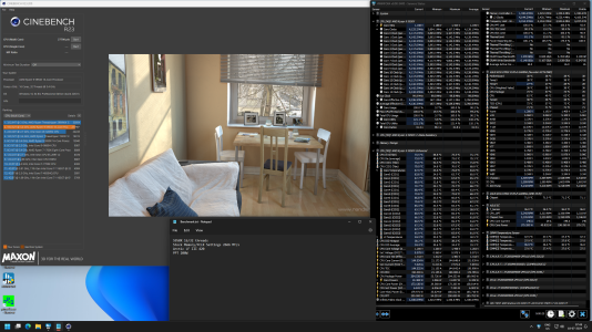

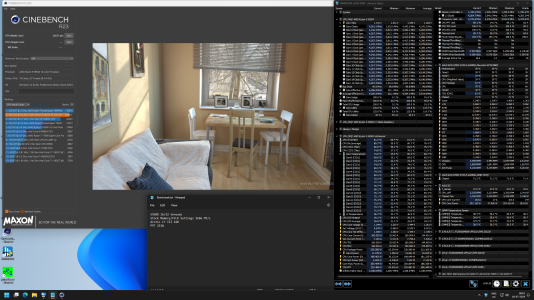

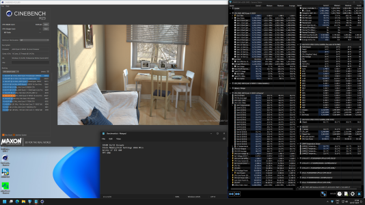

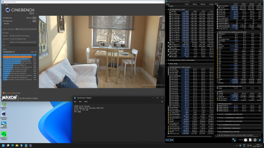

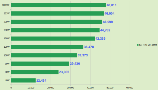

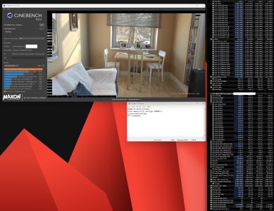

@igor_kavinski @Geddagod
Made possible by a generous benchmarking effort donation from @mostwanted002, I've got stock 5950X figures to add to the performance and performance per watt graphs. For your convenience I've collected the pertinent data here, but also attached screenshots.
Side note, the 5950X hit other limits (EDC/TDC) when PPT was increased to 160W, so 160W and up are done with unlimited EDC/TDC to leave PPT as the only constraining factor. Otherwise, every setting is stock.
Second side note, it didn't take well to 40W PPT and ended up running 44W PPT, which is why there are 4 extra watts core power compared to the rest of the power levels. The score is already so low due to poor scaling I'm giving it a pass.
40W - 3691 - 17.9W core
60W - 8328 - 33.3W core
80W - 13700 - 53.6W core
100W - 19260 - 73.6W core
120W - 23878 - 93.3W core
160W - 25822 - 133.3W core
200W - 27790 - 173.3W core
230W - 28155 - 198.5W core
253W - 28253 - 198.4W core
U/lW - 28390 - 198.4W core
