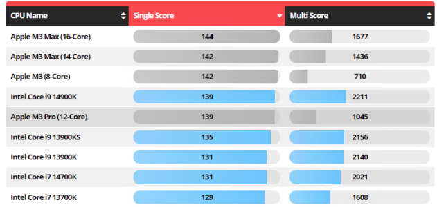

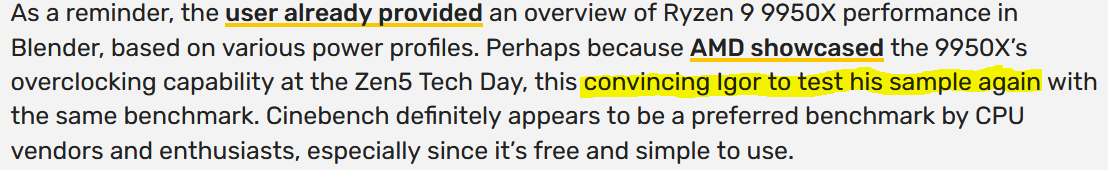

Awesome, please convey my thanks to ES user! So its one point from the M3 top score at 5.65GHz. Very nice. Do you know if he had to finagle anything to get here / this is with boost 'up to' 5.7GHz?
Looks like max clock recorded was 5.65GHz in HWinfo. That means its possible we'll see another 50-100MHz for retail, possibly topping the M3 score. Very nice.

What happened to PBO and why is the CCLK limit now 5650 Mhz?
R24 ST it is, if it looks like he can get it close to 5.7/what should be stock boost. If it doesnt look like he'll be able to do it, I'd rather not give that kind of bait to the trolls. In that case I'll take a max tuned MT run. :p
He wanted to see stock boost/fmax for this ES i guess (?)
I asked for 5.7 ST to see what retail will bring. Igor said that may not be possible with this ES, but they would try. So its unclear if retail will behave this way, but it seems like max freq should at least touch 5.7 just through the process of booting into Windows on retail, which was not the case with ES. Whether or not retail will reach a tiny bit higher and average 5.7-5.75 during this test is unknown, but this is close enough to reasonably expect at least this score on all properly cooled 9950X retail CPUs.
