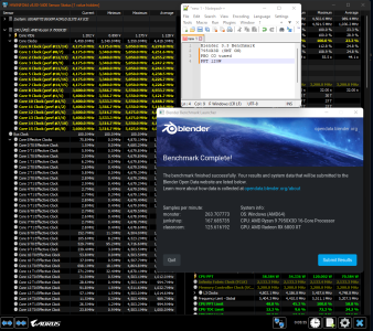

Because the correct memory Channel Reporting came with 6.3. Your first screenshot is 6.2.1
Understand, but tuning it makes it even faster--ie the 9950X is specifically cited to be CO tuned + 120W PPT. So it has every possible advantage, but still seems to be no better than the gent above's 7950X @ 120W PPT?
Still faster, it seems. Or i'm doing something wrong. Typical in-benchmark clocks on the first screenshot
I guess you are not running 3.3 version?

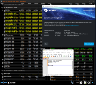

This is my 7950X3D (Blender 3.3 bench, SMT OFF, PPT 120W, CO tuned)
It seems to me, Zen 5 AVX512 full implementation has a great impact here (I guess Blender uses AVX512)

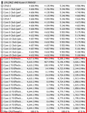

I thought we already concluded that SMT was not off, it was just a special mode of hwinfo?

Can you post scores with SMT enabled to compare against the other 7950X3D ? 👍
here it is:
Thanks for confirming, both numbers for the 7950X3D seems about right then 👍 (+- ~4%)

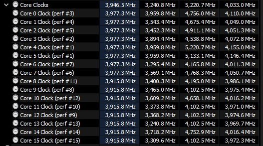

So far it seems like the Zen4X3D and Zen5 ES results are about even at the same PPT targets, which i would say is good thing (although the Z5 beat your Z4X3D at 120w example above)
But do note the clockspeed difference.. We already know what happens when Zen4 get above 5000mhz allcore, will same thing happen at 4000mhz for Zen5 or will it keep going ? 🤔

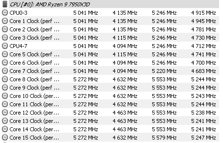

tsamolotoff's 7950X3D clocks while running the benchmark

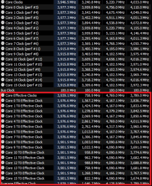

PS: to the guys taking screenshots with 7950X3D and 7950X, if you reset hwinfo 1sec after you have started blender and take screenshot the very second benchmark ends, you wont pollute your hwinfo data.
(hwinfo updates with idle numbers like 1-2 seconds after blender benchmark ends)
PS2: we're also waiting for vanilla Zen4 numbers as its not clear for me if v-cache sees any benefit in blender.
bclk overclock ?
A bit of eclk compensated with -fmax, my cpu can't do above 5750 in ST.

IMO ES sample scores fits with SMT OFF, not a hwinfo special mode.
