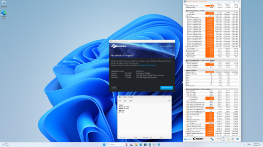

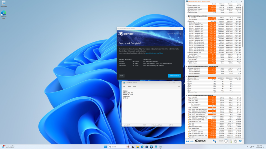

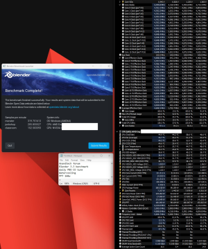

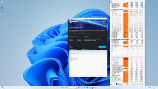

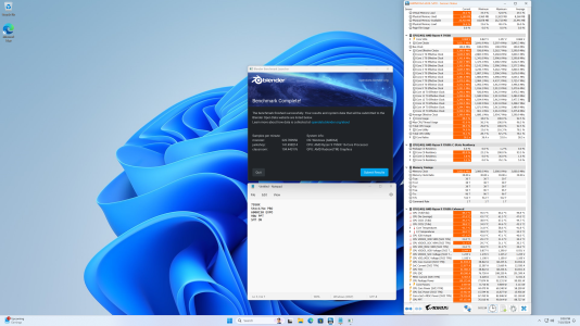

Blender Benchmark 3.3.0 runs: Fully stock 7950X, 6000C30 EXPO (no high bandwidth, no low latency modes).
When comparing these scores to the 7950X3D runs here, I think we need to bear in mind the 7950X was very sloppy with the V/F curve, taking a hammer to it to get max boost clocks at whatever the power cost. The 7950X3D is, comparatively, extremely stringently tuned with regards to V/F curve and will manage to boost higher clocks under all circumstances until the 7950X exceeds its power draw considerably.
This is a launch day 7950X sample. Its possible they improved the V/F curve since launch in newer samples. But I think this is a fair comparison to the alleged 9950X. Much more so than an incredibly-finely-tuned-out-of-the-box 7950X3D.
60W PPT
90W PPT
120W PPT
230W PPT (Stock)

So that would put ZEN5 exactly where i expected it in terms of efficiency. Something between "basically same as ZEN4" and "same clock at same power -> ~16% faster at same power".
In the screenshots of the 9950X, it's clearly using a number more watts for uncore, giving the cores fewer watts than in my case. Might be because it's an ES, might be because of whatever weird tuning has been done with it.
If you compare my performance at the core power shown vs the 9950X performance at the core power, it makes the 9950X look a bit better

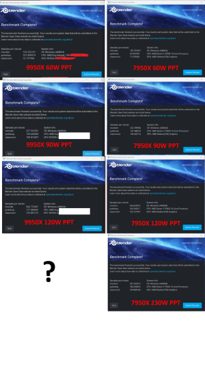

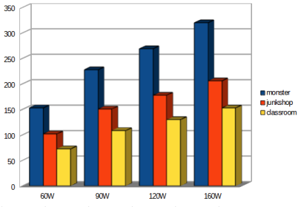

Thanks for comparison 👍

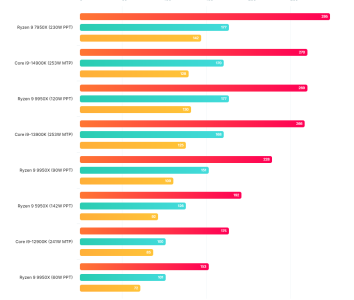

Your 230w numbers also pretty much matches the 230w 7950X here: (taken for WCCFTech)
But sadly its still alittle unclear to me if the 7950X3D are benefiting from the v-cache on CCD0 in blender, or if its all down to voltage tuning for that SKU, since it seems to outperform the 7950X in the powerlimited scenario we're looking at in this thread
*edit*
One more picture from the commet section over there to make it clearer: (@Hail The Brain Slug results used)
It seems like the junkshop sub-bench is standing out with the largest delta, what makes it different compared to the other two ? 🤔
