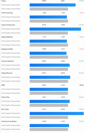

SteinFG
Dec 29, 2021
728
865
The MT score is almst the same as 9900X. Does GB scale past 12 cores? If it does, there's some other limitation it seems. 1720588392733.png
Edit: 7950X and 7900X also have similar issues, so it seems that GB doesn't scale past 12
Abwx
Apr 2, 2011
11,868
4,846
The MT score is almst the same as 9900X. Does GB scale past 12 cores? If it does, there's some other limitation it seems. View attachment 102713
GB6 scale at 18% from 6 to 8 cores, that is 33% more cores, and only by 8% when adding 50% more cores from 8 to 12, even ST subscores that are known to be vastly parralel on real world have limited scalability on the MT subscores, so that s an irrelevant bench when it comes to MT.

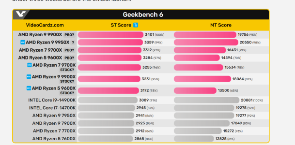

Gideon
Nov 27, 2007
2,028
5,033
Det0x
Sep 11, 2014
1,463
4,995
Enabling PBO alone means nothing for Zen4 / Zen5 ST score in GB6
Its only curve optimizer settings, +offset FMAX and temps what would affect ST score
So in my opinion, i kinda doubt those are tuned/opimized/overclocked (PBO) settings for that 9950X
Think the difference in scores is down to different system configurations (windows install+silicon quality+cooling+bios settings etc -> all are stock runs 🤔
Just my 2cent :)
Nothingness
Jul 3, 2013
3,294
2,362
The only test that scales well in GB6 is the ray tracing one. If you're only interested in that property, you should only look at that test. Thing is that in real life most applications alas don't scale as rendering ones.
Nothingness
Jul 3, 2013
3,294
2,362
As I wrote above, if you look at the ray tracing score, you get more or less what you expected.
As I wrote dozens of times: don't concentrate on aggregated scores, study subtests results. GB6 global MT score doesn't reflect perfect scaling at all, that was a huge departure from GB5, and IIRC this was explained by PrimateLabs.
