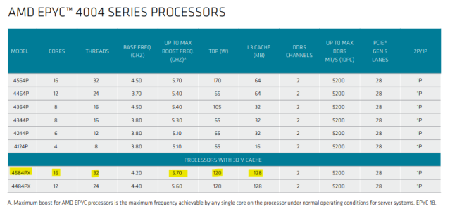

Or people who want cache should stop being cheap and just get a Milan-X with 768MB cache :)
I would like to see review of this Epyc 4584PX (AM5 socket). I assume this might do well on SQL Server and "MS Flight Simulator" type loads 😁
EDIT: I missed that it has the same amount of L3 cache as consumer part, so vcache only on one CCD still :-(

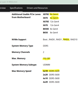

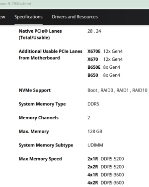

Curious regression on the PCIe lanes front for the new chipsets.
Does RAID5 mean that Zen 5 has hardware RAID support???
  • X870E is a renamed X670E with mandatory USB4 capabilities, which costs 4 lanes.
  • X870 is a renamed B650E (just one Promontory chip), so just 8 additional lanes from the start, and it also has mandatory USB4
