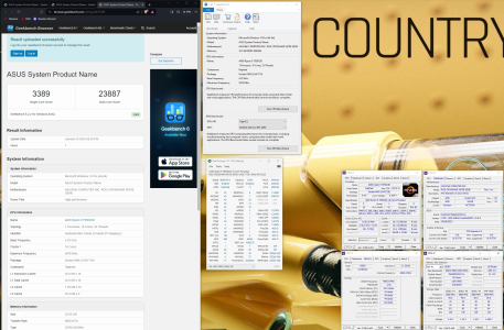

Here's somewhat tuned 7950x3d results (my ccd1 is trash, can't clock above 5750 at all, surely dom can provide even better results on his binned CPUs):
Prefer cache:
Prefer frequency:

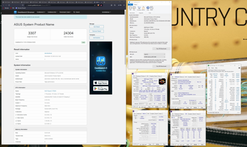

This is a very random "benchmark", here's two more results, I've run them one to the next with no reboots or settings changed:
Reactions: lightmanek
28,174
19,218
OR the frequency fluctuation on Zen 4 is pretty random?
Comparing both, the MT score variation in the subtests is much less than the ST one, so the all core frequency stabilizes better to a narrow range.
Prefer cache:
Prefer frequency:
7950X3D super maxed out
Older run with vanilla 7950X
