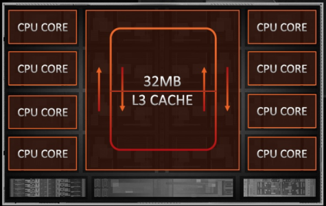

My guess is it's some sort of analogue of intel's mesh interconnect. Made to scale past 8 cores in the future. Quick thought:
Some folks (RetiredEngineer et al) already mentioned Zen 3 'ring bus' is not exactly a ring.
Ian Cuttress also noticed from his tests the interconnect is not exactly a ring.
The consensus is that it is a bisected ring like below. Cores are placed on all the periphery of the ring unlike as depicted.
In our testing, our results show that while AMD’s core complex is not an all-to-all connection, it also doesn’t match what we would expect from ring latencies. Simply put, it’s got to be more than a ring. AMD has been very coy on the exact details of their CCX interconnect – by providing a slide saying it’s a ring reinforces the fact that it’s not an all-to-all interconnect, but we’re pretty sure it’s some form of a bisected ring, a detail that AMD has decided to leave out of the presentation.
So the ladder interconnect could be a double/triple bisected ring which would probably be an extension of the current interconnect.

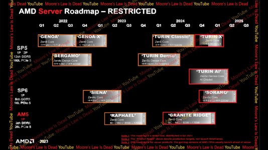

So, MLID has insider slide of Zen5 release date? Should we believe him this time?
Exist50
Aug 18, 2016
2,452
3,106
Nothing about this roadmap strikes me as obviously fake, at least. There are a couple of interesting details, though. Leading with Zen 5c instead of Zen 5 is notable, and naturally draws parallels to Intel's similar strategy with Sierra Forest vs Granite Rapids. "Turin AI" is new, so that will be interesting. Swapping a CPU chiplet with an AIE-ML one?
Above all that however, it looks like the base Zen 5 cadence is staged a full 2 years after Zen 4. That's a bit later than we might have liked. Seems like the longer Zen 4 timeline might not have been a one-off.
And as a last note, something is weird with that 'Turin-X' box. Wonder what was blacked out.

who keeps leaking stuff to that guy? is there a larger version of that picture for those of us with terrible eyesight?
did i miss something because from what i can make out base z5 aka granite ridge is showing up as beginning midway of q1 into q4 which i assume is a window of release or were you referring to something else?
Exist50
Aug 18, 2016
2,452
3,106
I think the right hand side of the box is what matters, given that it's marked as "prod". The rest is likely either meaningless, or some sort of post-silicon timeline.
But regardless of what it may be, I am just wondering why would somebody pass on such technical information to YouTubers who are most likely not able to comprehend the significance of it all.
First of all the question remains how many stops that ring has. Is the IFoP a separate stop or is it directly connected to the L3 somehow?
If the (bidirectional) ring only has 8 stops, then average hops already are pretty low with around 2.3 hops (if I did not mess up calculation). A bisection would further reduce this to 1.6 2.0 (corrected, after having counted all hops for half of the nodes)
From then on it becomes a matter of heavy diminishing returns which might not be worth the transistor and energy budget.
I do not even see a case for such a ladder on eight stops, as the name implies that the cross links do not cross each other.
To me, further cross links do only make sense for Zen5c, where it is rumoured to switch from a 2x 8c CCD on Zen4c to a unified 16c CCD.
that makes no sense. the chart shows genoa coming out in q3's timeline this was not the case it was a late q4 product launch. Genoa x is also far too early on that chart and we're well into q2 now. Bergamo is a mes too. i figured a way to enlarge the photo upload there is a 2nd note stating these are production targets not timelines but was is more confusing is raphael on am5 is listed towards the end of 2023 and not 2022. either mlid is making crap up which is no surprise to anyone with a single brain cell or he's been had, or he's been had and is too dumb to notice any of the errors.

If the (bidirectional) ring only has 8 stops, then average hops already are pretty low with around 2.3 hops (if I did not mess up calculation). A bisection would further reduce this to 1.6.
As I just realized, I of course messed up the calculation. The average hops for the ring should be correct, but the number for the bisectional ring is too low. I always forget that for a non uniform topology (more or less everything except ring and star) it is not sufficient to use just one node as the source for the counting and consider all others being equal.
On that occasion I miserably failed in finding a calculator for such things on the World Wide Web. Does anyone know of such a calculator where you can enter the number of nodes, topology, directionality, etc. and get the average hops?
No, that makes perfect sense. Officially launching about a quarter after they start volume production is more or less the standard timeline. Plus, they start shipping to a few customers ahead of the launch event.
I think that's meant to be the Ryzen Embedded parts, given that this is a server roadmap. The Vermeer ones just launched a few weeks ago, so the timing makes sense.
Not going to dismiss the possibility that the whole thing is faked, but at least from these details, I'm not seeing it.
A split ring (bisected), just means two rings - with one 'stop' (switch/router) from each ring to the other. 2 actually, for c-w and cc-w; but still just one stop for computing latency. You also need a 'node' for the IF connection to the ring (again, two of them). There is a math formula for it, but I don’t recall it at the moment. So, just start at node n=1 to n=10 and sum the latency for each node to the other, then divide by 10. I’m sure the route uses SPF (shortest path first). AMD could probably just make the IF node another route point - but I don’t know if they do. Intel had separate points for memory, I/O and ring to ring connections.
Anyway, pretty sure this is close to correct for napkin math - without knowing implementation details. Anyone who cares to can correct me.
