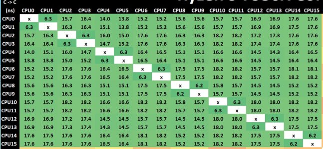

Some core to core latency measurements from AT
It looks like it needs 2 hops for two adjacent cores and average between 5 to 6 hops for the other cores.
ed:
From @Bigos comment below, this graph is with SMT indeed.

This graph is for a 8-core CCD. CPU0 and CPU1 are two SMT threads of the same physical core, hence massively lower latency.
This looks like the latency between physical cores (looking at the first row only) ranges from 13.8 to 17.6. You cannot really tell the number of hops just from that as there is the base L3 latency as well (and CPU0 & CPU1 do not communicate using L3, most probably). Just looking at CPU0 -> CPU2 and CPU0 -> CPU3 we can conclude the variance in this testing procedure is pretty large, as CPU2 and CPU3 are again two SMT threads of the same physical core (by looking at the latency between CPU2 and CPU3). We can still see some cores are closer than others and some kind of analysis involving math would be able to tell more.

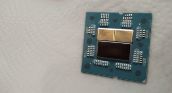

That's interesting. I would have expected a similar, almost identical IOd for Zen 5.
AMDK11
Jul 15, 2019
489
435
Chiplets look similar to Zen4. Maybe it's Zen4 with some IOd variant or a test version of the new IOd for Zen5 but still on Zen4 chiplets? On the one hand, a new-generation IOd prepared earlier for testing purposes could be combined with other chiplets, but it may as well be an APU.
