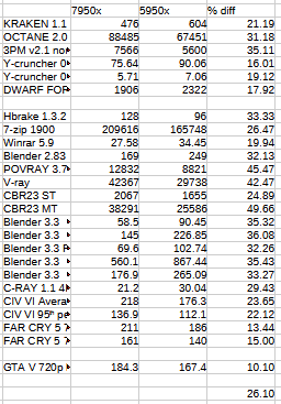

For example, here's the geomean I calculated from AT benchmarks where I removed anything below 10% improvement:
26% geomean seems pretty good from 5950X to 7950X.
