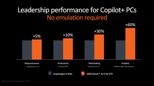

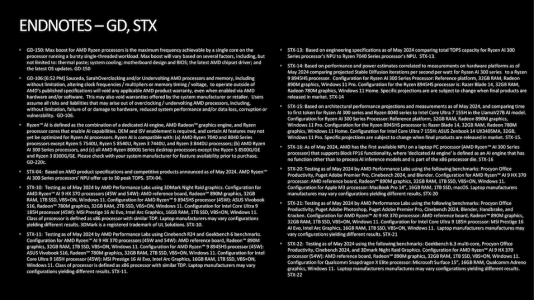

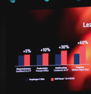

we have one look at 1t using GB6 3.0. HX 370 up to 5.1GHz vs X Elite up to 4.2GHz?.
Do we have endnotes for this slide?
28,174
19,219
Besides, what is the point of sandbagging something like CPU performance?
Could be because they are unsure of what Arrow Lake may be like. Zen 5 may be winning a lot of benchmarks in July against 14900K/KS (even by 1%) but AMD would prefer supremacy so they may have something in store for the Arrow Lake launch (optimized AGESA, new models with boosted clocks, high speed EXPO kits etc). There's also the possibility that the Zen5X3D by year end may be based on 3nm silicon and so may boost to 5.7 GHz at lower power, heat and voltage without harming the V-cache die. As of now, the situation just seems too muddy.
Reactions: Tlh97 and carancho
coercitiv
Jan 24, 2014
7,510
17,967
We have, but you're not gonna like the info, AMD is hellbent on having errors in all of their important slides/end-notes. How they managed to write GB 1T in the slide and GB multi-core in the end-note is anyone's guess.

so I guess that Lenovo manager was right after all, because final IPC in graph is kind of "fishy" and the question is whether AMD did not slightly improve that average to 16% by include particular cherry- picked tests in graphs such as Geeekbench 5 a Geekbench 6 so without them the average IPC would be slightly above ~10%
poke01
Mar 8, 2022
4,916
6,263
I think I got the highest Windows GB6 result for X Elite. 5% more would put AMD HX 370 at M3 level of 1t in GB6 3.0
If we take one of the highest Ryzen 9 8945HS scores and add 16% IPC it adds up more or less.
