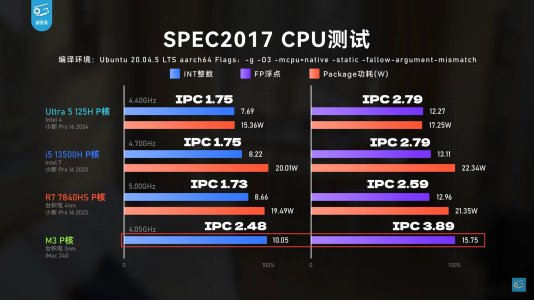

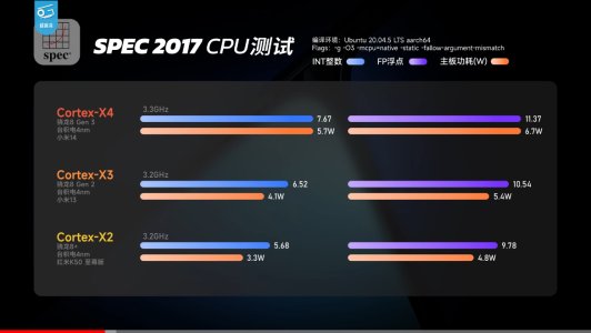

No, Geekbench is fair too. Wider code footprint in some ways? Both are fine. No diss to Specint tho.
Bruh?
Look above — not Yo/Y but this year. And Arm has been barreling forward for a while now. X4 was a 10-12% IPC improvement and really close — mid single digits — to Firestorm IPC, closer than Zen 5 for sure. X3 was around 5-8% gains I think and even then was doing rouuughly mobile Zen 3 ST at 5W total power in 8 Gen 2 or 9200, and ofc at less frequency.
It’s honestly strange people are so ignorant about Arm’s cores.
Matching Apple is a high bar on IPC, but even more so with power as the X4 showed, it’s true they’re not A+ cores and probably Qualcomm will have some power leads I can see too.
But “even” being a Firestorm Walmart/generic core like the X4 was (hitting 1600-1690 GB5 for ex, or at 2300-2350 in GB6) with worse power characteristics than Apple — but still doable in phones — is self evidently better than what AMD/Intel could offer in PCs for a similar perf.
The sneering about Arm’s Cortex IP is fair vs Apple and arguably QC, but not vs AMD and Intel anymore save probably some server stuff.
Their own SPECint numbers show noticeably lower IPC. GB6 is not a bad bench, but there are multiple reasons SPECint is considered the standard as far as generalized benchmarks go. If SPECint is the standard for everyone else, it should be for Arm as well.

Their own SPECint numbers show much lower IPC. GB6 is not a bad bench, but there are multiple reasons SPECint is considered the standard as far as generalized benchmarks go. If SPECint is the standard for everyone else, it spoils be for Arm as well.
I do think it’s partially being pumped by the 50% increase in SIMD registers to be fair, but that’s still quite valid. And only partially.
They had like a 34% IPC lead in SpecInt over Phoenix with the X4 (8 Gen 3).
And I don’t think AMD got 16% IPC in SpecInt 1T did they with Zen 5? Was maybe slightly higher than Arm’s, like 10% vs 5-6%.
We don’t have any SPECint reference for Zen 5 yet. In the past, AMD’s IPC number has lined up closely with the SPECint results despite them showing weird benchmarks in their IPC comparisons but, as I already said, we’ll obviously need 3rd party reviews with SPEC to confirm this with Zen 5. The point is, given the standard we’ve used at least for several generations now, AMD is not lagging in IPC gains on a CAGR basis and may actually be slightly leading the industry in this regard for the last few generations, depending on how independent reviews turn out for the latest cores. So despite the hype train crash, they’re still doing pretty good in this regard.
