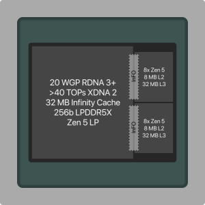

Unless we've learned something different, the only precedent that AMD has established for combining their P cores and their C cores on the same die, Phoenix2, has a unified L3 for them both.
And Zen5c chiplets supposedly feature a 16-core CCX. Hard to imagine why Strix Point would have separate CCXs given both those points.
HurleyBird
Apr 22, 2003
2,818
1,553
Because they serve very different purposes.
I dunno, I'm struggling here. Big increase to die size and average core-core latency for a small improvement to intra-CCX latency seems like a bad trade. Doubly so when you only have 4 cores in the big core complex and games are standardizing around octocore.
Power gating? Maybe you can turn off one CCX entirely when it isn't needed? But with a smaller L3 you go out to main memory more often, and inter-CCX communication is more expensive.
The usual answer to these things when it comes to AMD is a combo of bet hedging and time-to-market.

To be very clear, if Strix has two separate L3 caches, it will perform significantly worse on many important loads than if it has a single cache with 12 cores attached to it.
Couple of problems with that:
- adding 4 stops on the ring bus would slow down all other addresses
- If L3 runs at core frequency, all cores would have to be on the same clock speed (which would be a deal-breaker of the Zen 5c cores)

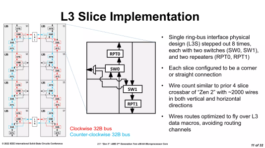

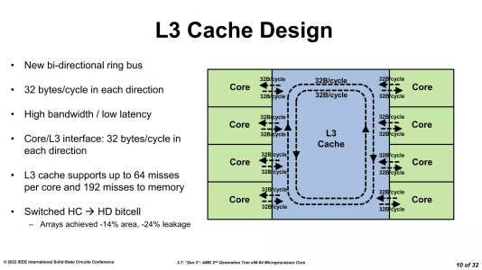

What ring bus? When the 8-core CCX debuted with Zen 3, iirc there was an interview stating that the new CCX was neither fully point-to-point nor a ring bus. If it were just a ringbus, adding more cores would be a much less involved process.
Edit: Can't corroborate my memory. Am I misremembering this??
adroc_thurston
Jul 2, 2023
8,616
11,336
Naaa.
It's a quad-core with a tumor on the side.
Relevant loads will fit into the premium quad, and cinememe/low power ghetto stuff will do fine on dense CCX.
Please I beg you read the 2022 ISSCC Zen3 presentation.
We will see Turin D CCD has a ring bus with 16+ stops or if there is some sort of enhanced ring bus that Adored TV speculated on earlier...
Neither.
