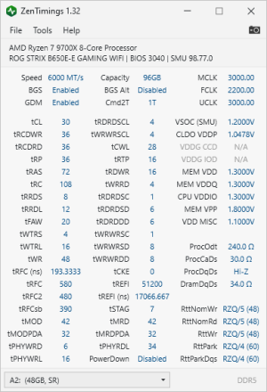

Has anyone with ASUS board fiddle with memory impedance values? ProcODT, DriveStrength, etc. I cannot seem to change those values, at least not in the way I am doing. Are there rules that I need to follow, e.g. certain values need to be paired, x value cannot excced y, etc.?
Trying to make odd memory combination work. I recently upgraded to 2x48GB from 4x16GB, and wonder if I can make 4 mismatched sticks work together. (2x48GB + 2x16GB)
I played with it a bit about a year ago. Not on mismatched DIMMs. Tried to get 6400 stable on two 32GB modules. It didn't make an appreciable difference and only resulted in me having to clear/reset BIOS settings.
Do you really need the extra 32GB of memory? Could just dial back speed and primary timings.
What speed do the Auto settings give you when you populate all the slots? Note down the values the Auto mode arrives at and then start experimenting, decreasing timings or increasing voltages and speeds until you reach stability. It's a painful process so be ready to tear your hair out.
Depends a lot on the memory chips too. I had a Samsung kit that was awful and wouldn't budge beyond 4600 MT/s on my Z790 mobo. Got a Teamgroup 7600 MT/s kit with I think Hynix chips and it went all the way to 7000, the max supported by my mobo.
Things might be different with your board or with modern AGESA but last year when I upgraded from a 2x16GB SR kit to a 2x32GB DR kit, I made an attempt to run 2x48GB (16+32) per channel.
No matter what I tried the system would never POST at all under any circumstances. I figured the IMC just couldn't deal with mismatched rank dimms.

Same thing here. I was not able to boot with 4 sticks (2x48GB + 2x16GB). I had been running 4x16GB (2x16GB Samsung and 2x16GB Hynix DIMMs) for the past year without an issue, which made me think why not.
I run VMs in a ram disk. You should try it. It's very responsive and also very secure. :D
This is what Zentimings reads on my current 2x48GB setup:
ProcOdt 240 seems excessively high. Most others I've seen online for 4 sticks of DIMMs are 60 or below, so I was thinking that might be the culprit. But when I tried to change that value in the BIOS even just for 2 sticks, the changes I make do not seem to apply. (?)
Try mismatched DIMMs in the same channel, i.e. 48GB paired with 16GB on the preferred slots channel. If that boots, populate the other channel.
That is not something I have not tried yet. I will do that over the weekend. Thx for the pointer

I just got it to post reliably (at stock/auto JEDEC 3600, the 2x2R default) with a trident z5 neo 6000C30 2x32gb kit and a 6000C30 2x16GB kit. Expo won't work in this config at all.
7950X3D on an X670E Aorus Xtreme on the latest agesa 1.2.0.2. I guess improvements have been made, it would not post on older agesa when I tried (early 2023).
I'm temporarily using the 7950X3D in this setup until the 9950X3D releases. I'm also waiting for better high capacity memory options. No 6000-6400 Expo 2x48GB kits, and no 64GB dimms at all yet sadly.
