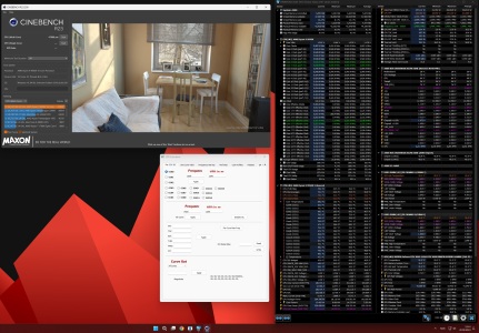

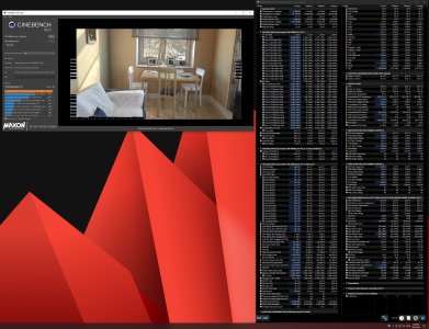

My 9700X with 2167 FCLK needs 0.095 less volts to run stable compared to my 7600X with the same FCLK speed in the same motherboard. The MemTestPro test for over 700% coverage in my system with an X670E board & EXPO 5600MT/S ram profile. I tweaked only the tREFI & both SCL's minor timings for that ram profile, but in the greater scheme of things, that's just a minor tweak to the ram itself. The surprising thing I found is the low SOC volts now needed, even with LLC of 3 for SOC which is the lowest LLC my board can do for that bios option.
So consequently, my 9700x runs significantly cooler than before thanks to the SOC not needing as much volts to be stable at 2167 FCLK & all this is with first iteration of AGESA code for Zen 5. Also much easier to sustain 5500MHZ PBO boost on all 8 cores with SMT enabled (auto settings for PBO) continuously during this test with MTP.
(note the slower last thread in MTP is because of Windows 11 23H2 scheduling issues)
To get perspective on some environmental factors influencing temps in this screenshot:
1. Antec C8 case, closed up.
2. Case fan profile on silent except cpu on standard.
3. Deep Cool AK620 tower cooler + Thermal Grizzley Kyronaut extreme TIM
4. RX 7900 RTX idling below the CPU
5. Windows power profile on high performance.

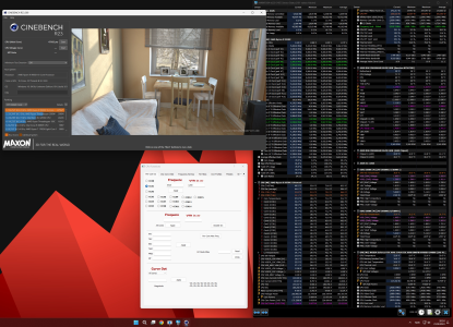

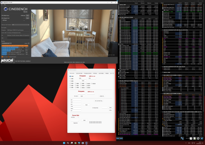

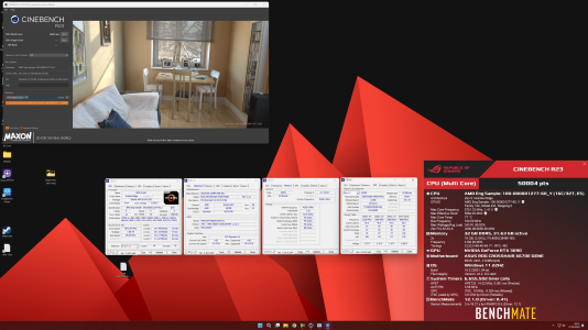

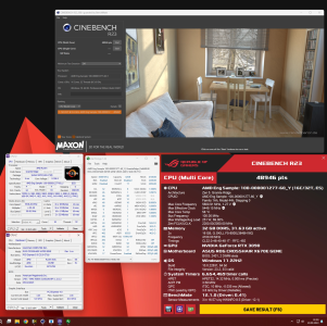

Seems like a slow Tuesday, so i guess i can share some binning results for my 3x 9950X retail + 1x 9950X ES, now that i have sold all my Zen5 cpus i wont daily (lost ~200$ per cpu on the used-market)
A few words before we get into the data:
  • The goal was to complete 3x MT runs in a row in Cinebench R23
  • Static cpu voltage was set at 1.200 vcore --> around 1.156 vcore get while running (since set in windows only hwinfo motherboard vcore is correct reading)
  • Static clockspeeds was upped on each individual CCDs in 25mhz intervals before it could not pass 3x runs back to back
  • I tried to keep the watercooled same loop GPU idle temp as close to 20 degrees as possible for all runs (most reliable for me)
  • Non of the runs were done at stock 5600MT/s speeds, but not maxed out either --> was just what i was running at the time of testing
  • Nevermind the R23 MT score themself as i had lots of stuff running, lowering the scores. Point of interest was clockspeeds
  • HWinfo got reset before each run, all runs seems to be about 256w powerusage while running Cinebench R23 MT
  • Stupid windows11 printscreen would only take screenshot the same millisecond the benchmark ended on all but the ES, but values in hwinfo hadn't had time to update
Retail #1 9950X sample
Max stable FCLK = 2167mhz
Max static R23 ST clockspeed @ set 1.4core = 5825mhz
Max completed MT clockspeeds = 5500mhz CCD0 / 5450mhz CCD1
Retail #2 9950X sample
Max stable FCLK = 2200mhz
Max static R23 ST clockspeed @ set 1.4core = 5850mhz
Max completed MT clockspeeds = 5550mhz CCD0 / 5425mhz CCD1
Retail #3 9950X sample
Max completed MT clockspeeds = 5500mhz CCD0 / 5425mhz CCD1
ES 9950X delidded sample
Max static R23 ST clockspeed @ set 1.4core = 5900mhz
Max completed MT clockspeeds = 5475mhz CCD0 / 5525mhz CCD1
I have binning data for all samples at 1.100 vcore set also, but it pretty much shows the same as with 1.200 vcore set

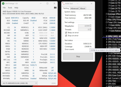

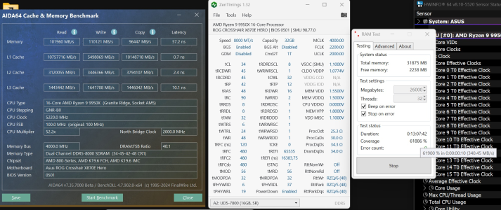

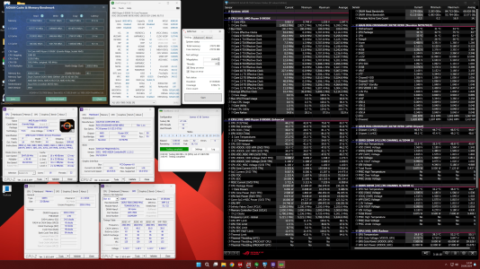

ASUS new Nitropath is definitely doing some work!
For the first time 8000MT/s memoryspeeds and above are viable on 2DPC (4 memory slots) motherboard for daily usage, with full boot to boot stability (which is something that have plagued previous gens)
I have had some time to play around with the X870E Hero in my small air-cooled livingroom media computer (overkill i know 😅), and i have achieved full stablity running 8000MT/s together with 2x16GB Hynix A-die. And best of all, this is using all stock/auto memory training settings, no fiddling with taps and RTT+proc settings required
Should also note that this computer is also using the IGPU on the IO-die for display, which is something that makes it even harder on the memory-timings/IMC, ontop of this being a 4dimmer motherboard. 👍
Hardware used:
  • 9950X @ fully stock boosting
  • X870E Hero
  • Noctua Air cooler
  • 2200mhz FCLK
  • Teamgroup UD-5 7800MT/s XMP a-die memory with my custom barts heatsinks @ 8000MT/s CL34-45-42-48
  • This computer have no casefans installed
Results with A-die: (most Zen5 cpus capps out at 8000MT/s speeds while a few can do 8100/8200 for daily in optimal cooling/settings)
Full screenshot with 13 hours karhu + 3 hours testmem 1usmus + hwinfo open
Have also done some testing with Hynix M-die, but profile is not finalized yet
(lax timings)
All in all this motherboard is working flawlessly for me atm, have had zero hiccups, and best of all like i said above, full boot-to-boot stability with all auto memorytraining settings 😉
There are also some new settings in the bios i can share with you guys in the coming days.. CO safe curve anyone ? Basically two different CO curves at the same time, one for light work and autoswitch to a other one for heavy work ;)

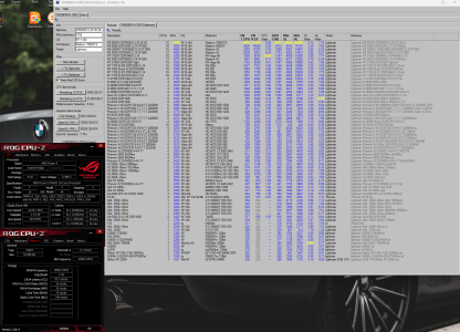

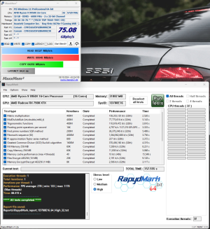

Just started testing stock performance with EXPO enabled.
Rapydmark High run with text log and Maxxmem2 screenshots please. Thanks!
Also, maybe turn off EXPO and try going for DDR5-6000 CL28? Should be easy now with mature kits on the market.
Reactions: lightmanek
lightmanek
Feb 19, 2017
429
916
I work a bit today ... 6h, but will get into tweaking once I finish my 87 tests at out of the box settings ;)
Will do these two for you, no problem, but might be tomorrow before I can.
PS. A shame as I had there my tweaked 7800X3D result and accidentally deleted it.
I remember ST score was 3052, so in this old bench, Zen 5 is significantly faster (7800X3D was running 5.25GHz ST)

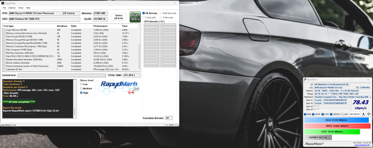

lightmanek
Feb 19, 2017
429
916
Here are the numebrs, still stock + EXPO, no other tweaks!
Tests report generated by RapydMark v1.2a (64 bits) https://www.frikiscape.com/rapydmark/
Date: 10-05-2024 (m-d-y)
Time: 20:43:41
CPU: AMD Ryzen 9 9950X 16-Core Processor (16 Cores)
Threads available: 32
GPU: AMD Radeon RX 7900 XTX
Resolution: 2560 x 1440
Operating System: Windows 10 Pro Build 22631 (Win11)
System memory: 31882 MB
Stress level: High
System ID: 1D788E16
Results of all tests:
Total time (all tests): 156.692 seconds
Test Type: Matrix multiplication
Iterations: 400M | Performance: 158,353,120 it/s (32th) | Time: 2.526 s
Test Type: MulDivAddSub (int,double,int64_t)
Iterations: 400M | Performance: 77,775,616 it/s (32th) | Time: 5.143 s
Test Type: Trigonometric functions
Iterations: 400M | Performance: 110,619,472 it/s (32th) | Time: 3.616 s
Test Type: Floating point operations per second
Iterations: 16K | Performance: 4,797 it/s 1127.219 GFLOPS (32th) | Time: 3.335 s
Test Type: Find prime numbers SQR method
Iterations: 200M | Performance: 40,290,088 it/s (32th) | Time: 4.964 s
Test Type: Fibonachi sequence (92)
Iterations: 4000M | Performance: 1,064,962,688 it/s (32th) | Time: 3.756 s
Test Type: Pi approximation Taylor series method
Iterations: 800 | Performance: 237 it/s (32th) | Time: 3.372 s
Test Type: Greatest Common Divisor (GCD) Euclid's algorithm
Iterations: 1600M | Performance: 370,456,160 it/s (32th) | Time: 4.319 s
Test Type: Fill Memory 256 MB
Iterations: 60K | Performance: 7,289 it/s (32th) | Time: 8.231 s
Test Type: Copy Memory 256 MB
Iterations: 60K | Performance: 11,838 it/s (32th) | Time: 5.068 s
Test Type: Memory cache performance (max 4 threads)
Iterations: 40 | Performance: 10 it/s (4th) | Time: 15.549 s
Last result: SizeMem= 8 kB Iterations= 65536 Time= 1 ms
SizeMem= 16 kB Iterations= 32768 Time= 1 ms
SizeMem= 32 kB Iterations= 16384 Time= 1 ms
SizeMem= 64 kB Iterations= 8192 Time= 2 ms
SizeMem= 128 kB Iterations= 4096 Time= 2 ms
SizeMem= 256 kB Iterations= 2048 Time= 2 ms
SizeMem= 512 kB Iterations= 1024 Time= 2 ms
SizeMem= 1 MB Iterations= 512 Time= 3 ms
SizeMem= 2 MB Iterations= 256 Time= 8 ms
SizeMem= 4 MB Iterations= 128 Time= 53 ms
SizeMem= 8 MB Iterations= 64 Time= 49 ms
SizeMem= 16 MB Iterations= 32 Time= 51 ms
SizeMem= 32 MB Iterations= 16 Time= 55 ms
SizeMem= 64 MB Iterations= 8 Time= 62 ms
SizeMem= 128 MB Iterations= 4 Time= 86 ms
Test Type: Files Encrypt AES256 (10 MB)
Iterations: 20K | Performance: 2,191 it/s (32th) | Time: 9.128 s
Test Type: Memory Encrypt/Decrypt AES256 (1 MB)
Iterations: 8K | Performance: 2,566 it/s (32th) | Time: 3.117 s
Test Type: Memory Encrypt/Decrypt Blowfish448 (1 MB)
Iterations: 8K | Performance: 3,565 it/s (32th) | Time: 2.244 s
Test Type: Memory Compress/Decompress 1 MB (Gzip)
Iterations: 8K | Performance: 3,187 it/s (32th) | Time: 2.510 s
Test Type: Files Compress 10 MB (Gzip)
Iterations: 4K | Performance: 1,159 it/s (32th) | Time: 3.449 s
Test Type: RSA Keys Generator (2048 bits)
Iterations: 2K | Performance: 539 it/s (32th) | Time: 3.676 s
Test Type: Hash SHA1/256/512 MD4/5 CRC32 RIPEMD160 (512 bytes)
Iterations: 1M | Performance: 18,909 it/s (32th) | Time: 52.884 s
Test Type: Random Numbers Generator (2048 bits)
Iterations: 200M | Performance: 35,790,980 it/s (32th) | Time: 5.588 s
Test Type: Bitcoin Address Generator
Iterations: 200K | Performance: 22,532 it/s (32th) | Time: 8.876 s
Test Type: Distances between points on Earth (Haversine)
Iterations: 1000M | Performance: 187,230,848 it/s (32th) | Time: 5.341 s
Test Type: Cathedral 3D Test
Iterations: 1 | Performance: FPS average: 278 | min: 133 | max: 1170
(Max threads) | Time: 88.572 s
For comparision, my previous 16 core Ryzen 9 5950X (Zen 4 era was soldiered on 7600 followed by 7800X3D) - mostly doubling of performance in 2 gens :oops:

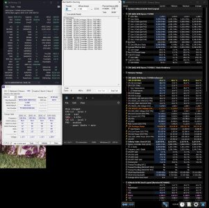

lightmanek
Feb 19, 2017
429
916

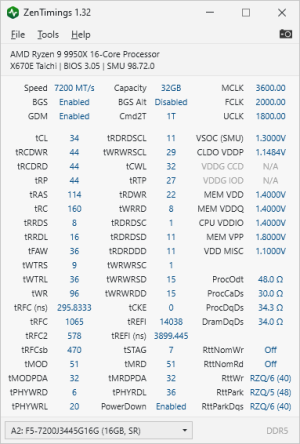

UPDATE with slight memory tweak + PPT 230W CO -15 and FCLK 103 Sync.
Time: 21:48:23
Stress level: High
System ID: 1D788E16
Total time (all tests): 151.454 seconds
Iterations: 400M | Performance: 226,628,896 it/s (32th) | Time: 1.765 s
Iterations: 400M | Performance: 80,857,088 it/s (32th) | Time: 4.947 s
Iterations: 400M | Performance: 111,141,984 it/s (32th) | Time: 3.599 s
Iterations: 16K | Performance: 4,844 it/s 1143.054 GFLOPS (32th) | Time: 3.303 s
Iterations: 200M | Performance: 40,908,160 it/s (32th) | Time: 4.889 s
Iterations: 4000M | Performance: 1,082,544,000 it/s (32th) | Time: 3.695 s
Iterations: 800 | Performance: 237 it/s (32th) | Time: 3.367 s
Iterations: 1600M | Performance: 379,957,248 it/s (32th) | Time: 4.211 s
Iterations: 60K | Performance: 7,774 it/s (32th) | Time: 7.718 s
Iterations: 60K | Performance: 12,804 it/s (32th) | Time: 4.686 s
Iterations: 40 | Performance: 10 it/s (4th) | Time: 15.197 s
SizeMem= 2 MB Iterations= 256 Time= 7 ms
SizeMem= 4 MB Iterations= 128 Time= 43 ms
SizeMem= 8 MB Iterations= 64 Time= 43 ms
SizeMem= 16 MB Iterations= 32 Time= 49 ms
SizeMem= 32 MB Iterations= 16 Time= 54 ms
SizeMem= 64 MB Iterations= 8 Time= 70 ms
SizeMem= 128 MB Iterations= 4 Time= 85 ms
Iterations: 20K | Performance: 2,633 it/s (32th) | Time: 7.594 s
Iterations: 8K | Performance: 2,659 it/s (32th) | Time: 3.008 s
Iterations: 8K | Performance: 3,605 it/s (32th) | Time: 2.219 s
Iterations: 8K | Performance: 3,277 it/s (32th) | Time: 2.441 s
Iterations: 4K | Performance: 1,240 it/s (32th) | Time: 3.225 s
Iterations: 2K | Performance: 508 it/s (32th) | Time: 3.902 s
Iterations: 1M | Performance: 19,232 it/s (32th) | Time: 51.995 s
Iterations: 200M | Performance: 36,390,104 it/s (32th) | Time: 5.496 s
Iterations: 200K | Performance: 22,899 it/s (32th) | Time: 8.734 s
Iterations: 1000M | Performance: 183,049,616 it/s (32th) | Time: 5.463 s
Iterations: 1 | Performance: FPS average: 285 | min: 136 | max: 1267
(Max threads) | Time: 88.505 s
This is safe for my memory kit (M-Die), but as for CPU, I need more time to find it's limits. So far everything is easy, I just re-applied my 7800X3D settings and it works like a treat. Memory controller is definitely better on this sample compared to 7800X3D. So far very happy with my upgrade!
20,040
13,738
The Maxxmem2 score is good. But in Rapydmark, it seems the test "Hash SHA1/256/512 MD4/5 CRC32 RIPEMD160 (512 bytes)" is giving your 9950X quite a bit of trouble. Are you sure you are on the latest AGESA?
20,040
13,738
Good improvement!
However, something is still a bit off with the Hash test in Rapydmark. For reference, a stock 7950X with DDR5-6400 is able to finish it in about 30 secs while my Zen 2 128 thread Epyc takes about the same time as your 9950X. I think your 9950X should be able to complete this test in 28 secs or less if some mysterious setting is set right.
