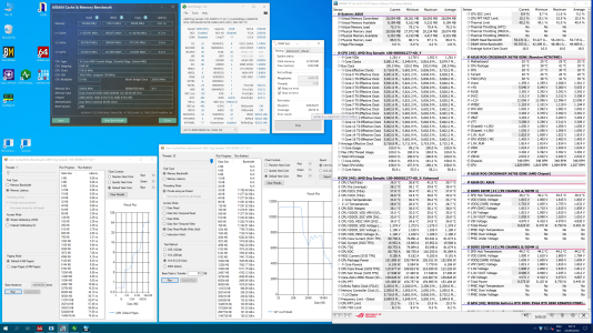

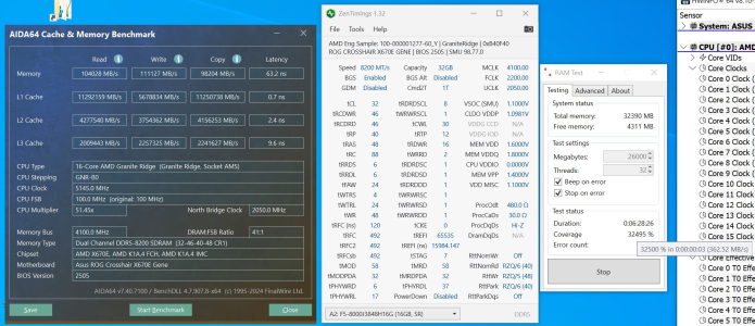

Can share my experience on the newest beta ASUS 2505 bios with agesa 1.2.0.2A vs previous bios with agesa 1.2.0.2
Overall memory Performance seems up as ive have hit a new high in regards to mb/s in karhu
Clams cache/memory benchmarks also shows an increase in memory bandwidth while latency stays the ~same as with earlier agesa's
Aida shows ~same bandwidth and higher latency, but as we all hopefully know, aida should not be taken too seriously since its so flaky and easy to manipulate.
So in the end i think this is a aida problem, not agesa problem since performance in everything else is better
Some numbers with ASUS bios 2505 agesa 1.2.0.2A
362.5mb/s over 6.5hours in karhu
Fullscreenshot

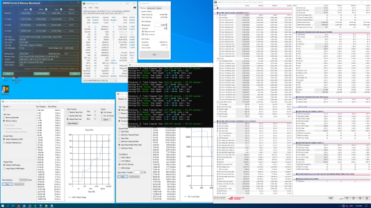

Numbers with ASUS bios 2401 agesa 1.2.0.2
354mb/s over 7 hours in karhu
For those interested in Clams cache/memory benchmark, both latency and bandwidth are included for 16core Zen5 above

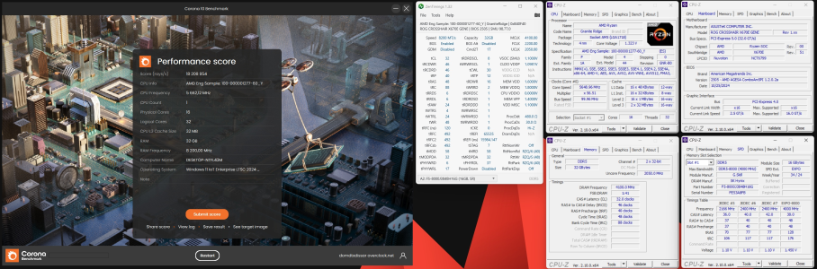

Did also a new run in the Chaos Corona benchmark which i know scales alittle with memory performance, but saw little to no difference here
  • 9950X (ES)
  • 32gigs a-die @ 8200MT/s CL32-46-40-48-88 GDM disable
  • 2200mhz FCLK
  • Large custom watercooling
Score = 18.2 mil
