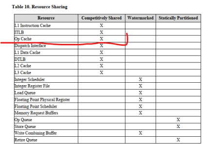

AMD has an update for Zen 5 at https://www.amd.com/en/blogs/2025/simultaneous-multithreading-driving-performance-a.html
This is incorrect for Zen5. Zen5 have whole front-end statically partitioned, it has decoders, op-cache and so on duplicated for each thread. They use significant amount of silicon just for smt which ain't used fot 1t at all.
Nope, they're all watermarked.
Zen5's micro-op cache is shared, per Chips and Cheese's testing.
uOP cache has capacity of 6k entries, if SMT is active each threads gets 3k entries. Geneally only decoders are statically partitioned (one decoder per thread even if you disable SMT in the BIOS). Eveything else is either competively shared or watermarked.
It is interesting that AMD repeatedly refers to resources to be competitively shared when in cases like the dual decoder it does seem to be effectively statically partitioned (due to a bug?).

MS_AT
Jul 15, 2024
941
1,866
I think they could hire somebody to proof read. I mean in software optimization guide for zen 5 you can read:
The maximum capacity of the Op Cache is 6 K instructions or fused instructions. The
actual limit may be less due to efficiency considerations. Avoid hot code regions that approach this
size when only one thread is running on a physical core, or half this size when two threads share a
physical core
. The Op Cache is physically tagged, which allows Op Cache entries to be shared
between both threads when fetching shared code.
What to me suggest at least watermarking as otherwise the limit would not be so precise. But in the same manual you can find a table:
Decoders are its own mystery since the messaging from the company could suggest either terrible internal communication (fixed decoder per thread was always intended and is working as planned) or a bug of some sort they were unable to fix but did not correct all the public materials after they realized they have a problem.

That Amd documentation also claims that op-cache is physically tagged and able to share code between threads. That don't make any sense to me - have anyone tested that being real? There's very potential side-channel possibilities there and extremely small posdible advantage from those additional physical tag op-cache hits between threads.
MS_AT
Jul 15, 2024
941
1,866
If you are doing fork and join that should dramatically boost efficiency (basically both workers do the same on different slice of data).
Could you explain the dangers you see? Leaking code is unlike leaking data I would expect, but side channels are nasty things.
naukkis
Jun 5, 2002
1,030
854
Op-cache is supposedly shared by physical tags - those gains aren't there because hits are only shared after tlb with simultaneous l1i and op-cache scans. Both threads would only perform optimally with their own op-cache hits.
With that scheme there's two timing path whether code is shared or not with other cpu thread(process). Ok, code timing side-channels aren't as bad as data but making one for no gains is still unnecessary risk.
