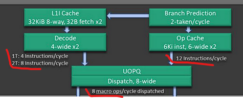

Could it be simply that it was not worth it and that is why it was disabled? Quoting clamchowder from C&C
My view is tunnel visioning on the decoders misses the elephant in the room. Backend memory access latency and frontend latency are holding back perf. You can find frontend bandwidth bound slots but there aren’t a lot of them. If the frontend was struggling to feed a 4-wide decoder due to BTB/iTLB/L1i miss latency, it’s not clear how much benefit you’d get from adding more decode slots that you also can’t feed. Also the uop cache covers most of the instruction stream even with kernel compilation.
I mean if the 2 decoders on 1 HW thread would require extra validation and they were seeing diminishing returns because the other parts of the system were not keeping up with demand, might be they simply gave up.
Also a question, which stage is doing the decoding now? Funnily it seems not to be the decoders themselves as both decoders and uop caches are sending instructions down to rename according to diagrams.
Is the decoder only doing part of the job? IIRC macro ops should be the "decoded" instructions that are later turned into uops before execution. Of course I might have misunderstood something. But in the software optimization guide they are making clear wording distinction that OpCache holds "instructions" vs macroOps in Zen4. Therefore what "decoders" are actually doing is identifying the instruction boundaries [the hardest part of the job I guess] if my understanding is correct.
Perhaps, but this is the last mile we are talking about. It does seems to be a bit better than Zen 4 at keeping the backend fed.
This is an architecture thread after all so answers are nice, hopefully tomorrow?
CnC for one took the liberty to stick with the term "Micro-Ops" for the output from the decoders = input to "micro-"opqueue and "micro-"opcache... in the articles which they published in August:
https://chipsandcheese.com/2024/08/10/amds-strix-point-zen-5-hits-mobile/
https://chipsandcheese.com/2024/08/14/amds-ryzen-9950x-zen-5-on-desktop/
https://chipsandcheese.com/2024/08/20/zen-5-variants-and-more-clock-for-clock/
Whereas in July, they used the prefix "macro-" in the same places:
https://chipsandcheese.com/2024/07/...t-how-30-year-old-idea-allows-for-new-tricks/
I am guessing it is purely in the eye of the beholder how micro or how macro these ops are.

CnC for one took the liberty to stick with the term "Micro-Ops" for the output from the decoders = input to "micro-"opqueue and "micro-"opcache... in the articles which they wrote in August:
I took my pic from software optimization guide for zen5, I have seen C&C were using Zen4 consistent labeling for their analysis, but don't remember if they commented anything in the text itself about this. David Huang also noted the difference in what is stored in the op cache iirc. So at least something changed and hopefully hot chips will provide some more definitive answers;)

IIRC AMD stated in the release slides that one of the changes was going from a uop cache of 6.75k macro-op on Zen4 to a 6k micro-op with fusion on Zen5. It might have been a marketing error. Or it could be a deeper change.
I hope this will get clarified at HotChips.
