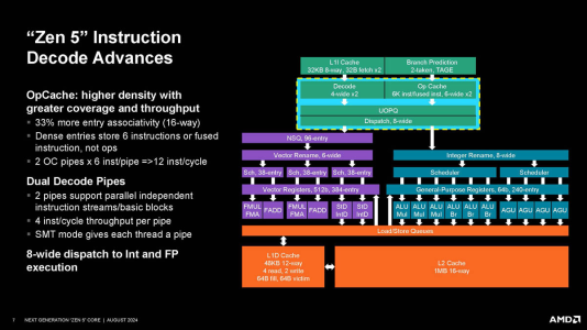

However, circling back to the decode. Pretty interesting that it matches a large part of the overall gist of these patents. 20220100519 & 20220100663
Still they mentioned parallel independent instruction streams coming from different basic blocks.
Even if parallel decode cannot be done within the same basic block, assuming the average x86 code runs for 8-10 instructions in a basic block we should be seeing this pattern play out where we get on average > 4 inst/cycle from the decode over a period of time.

Isn't the mention of "instructions" for the OpCache new (I think they previously said micro-ops)?
At least they make it clear that the OpCache doesn't store macro-ops contrary to Zen4 (something I had already highlighted for the launch of Zen5). OTOH I somehow doubt they really store instructions (as is in plain x86 opcodes). If that was the case it'd mean they'd have to decode and split them before entering the UOPQ. This has to be some form of micro-op.
I hope someone will discover something.
Do you happen to know what is the size of the basic block? Is that 32B? I also recall some papers where the decode is stopped if the decode encounters a taken branch I think. So with average 1 branch per 6 instructions and 4.5 B per instruction could make the throughput lower than 8-10 instructions. [the average data I gathered with quick googling so not sure how sound they really are].
This is what I was asking about some time ago ;)

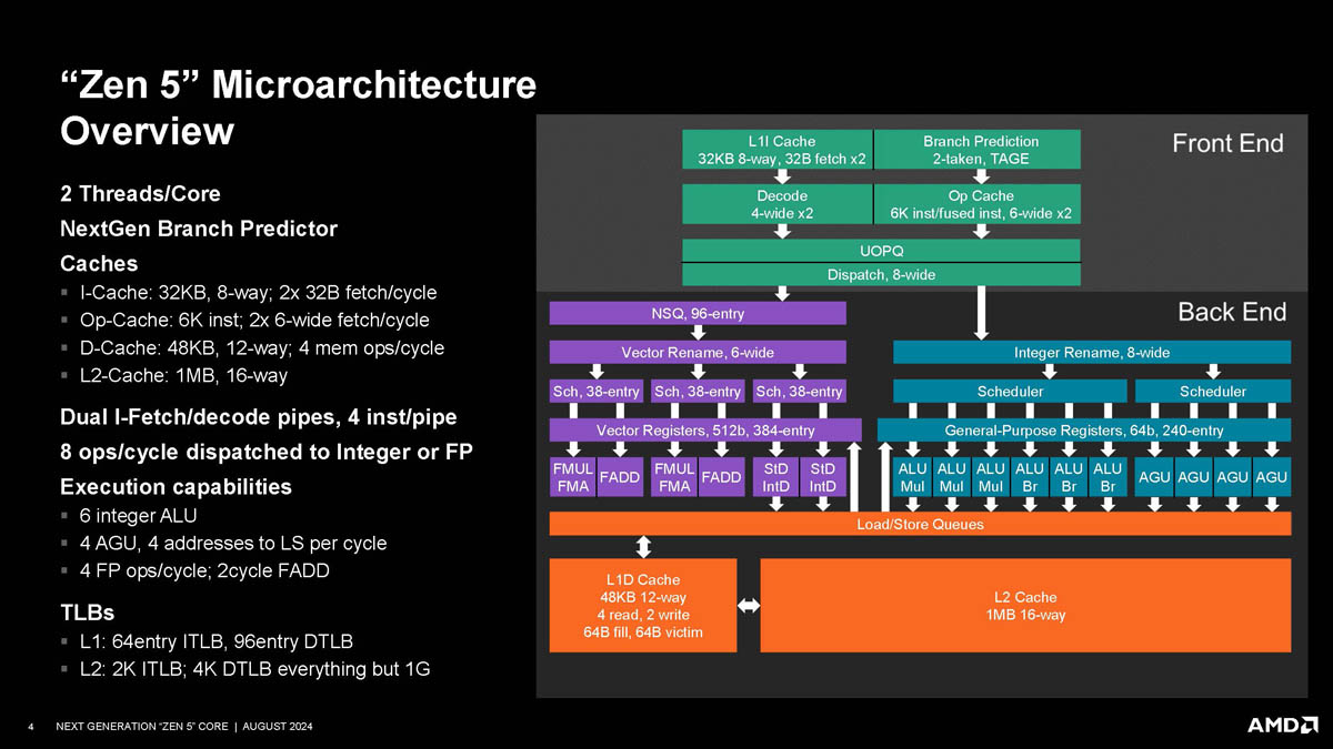

Also a question, which stage is doing the decoding now? Funnily it seems not to be the decoders themselves as both decoders and uop caches are sending instructions down to rename according to diagrams.
The diagrams are consistent between the original tech day slide deck, software optimization guide and HC slides. The diagrams in software optimization guide shows that apparently macro-ops are entering the Schedulers. And would suggest that macroOps -> microOps happens at rename and instruction -> macroOps happen at UOPQ stage.
But since the Software Optimization Guide looks like it could use an errata then not sure if we can trust those diagrams at all...
Basic block is basically beginning of a branch to the end of the branch.
Depending on the length of the instructions encountered a fetch block would comprise a varying number of bytes. Max fetch block is 32B.
And a basic block would contain a number of fetch blocks
The decode stops in case the BP cannot look beyond the next basic block and the current basic block is very small that the inst/cycle decode is enough to decode all insts in that single fetch block. Or stops due to stalling when existing ops cannot be dispatched due to bottlenecks in the backend.
Z5 BP can output two taken branches per cycle, so it already designed for this parallel look ahead execution.
The bad thing is that Z5 cannot use the dual decode in 1T.
Even if dual decode does not work with consecutive fetch blocks from same basic block , it should have been able to help do parallel decode on a second basic block and reorder the instructions when they come out.
Z5 2 taken branch/cycle is wasted here in most scenarios.
If we assume 8 insts average per basic block in common x86 code, that means decoder 0 can decode inst 0 -7 on one basic block and in parallel decoder 1 can decode inst 7 - 15 in another basic block, from a single code flow involving two jumps assuming the BP got the predictions right when looking ahead beyond the next branch. Then reorder inst 0 - 15 then before going to the op queue.
Even if not as great as working on two consecutive fetch blocks, the above sounds good enough, assuming there is enough OOO structures to handle this without stalling.
