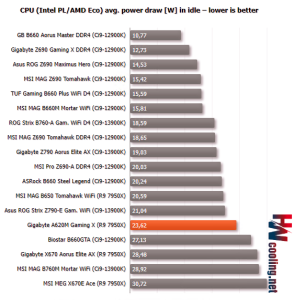

According to the chart below the idle power consumption difference is not that big between single vs dual CCD:
E.g. AMD 7700 is 21W and 7950X is 24W. So only 3W difference.
So if it's possible to build a system using 7700 that idles at 20W, it should be possible to build one with 7950X that idles at ~23W? That is unless the former assumes A620 chipset (which cannot be used with 7950X since A620 is restricted to 65W TDP CPUs), and the power consumption difference between A620 and B650 is big?
At computerbase they measured 12.2/13.9W for the 7700X and 13.7/16.3W for the 7950X at stock settings with Asus and Gigabyte MBs respectively, the 7950X with DDR6000 jump to 19.4/ 21.2W in these same MBs.
So RAM speed overclock has the bigger effect and MB is less important, at least for thoses two MBs and when it comes to CPU idle power, dunno for the rest of the MB power.
That being said with half the core count the 7700(X) doesnt need as much RAM BW as the 7950X.

B650 consumes less than A620 here.
But it's not just the chipset that differs in that test, it's also different motherboards. So it's hard to know what idle power consumption difference can be attributed to the A620 vs B650 chipset specifically.

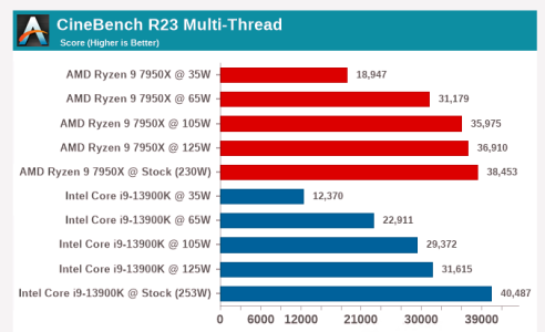

Does 13900K also have a "sweetspot" in that power limit range (i.e. much lower power consumption but without much lower performance)?
See how 7950X doesn't lose much performance with lowered power limits? It almost matches the 125W power limited 13900K at just 65W! That is almost double the power efficiency!

Yes, that could also be an option. But how would 13900K perform against 7950X / 7950X3D if all are power limited to e.g. 120W TDP? E.g. with regards to multicore performance and perf/watt. Does 13900K also have a "sweetspot" in that power limit range (i.e. much lower power consumption but without much lower performance)
There s no sweet spot, because with say 20% lower power the 13900K perf will tank more than when the 7950X is also 20% power reduced.
This is due to the fact that TSMC s process power/frequency curve is steeper than Intel s process, so when decreasing frequency power will decrease much more proportionately to Intel s process.
At 142W and 62% of the power the 7950X still retain 95% of its stock perf according to computerbase, actually that should rather be at 70% of its power since the CPU doesnt exhauste the full 230W at stock, but still, impressive number, at 88W and 38% of the stock power perf is still 82%.
