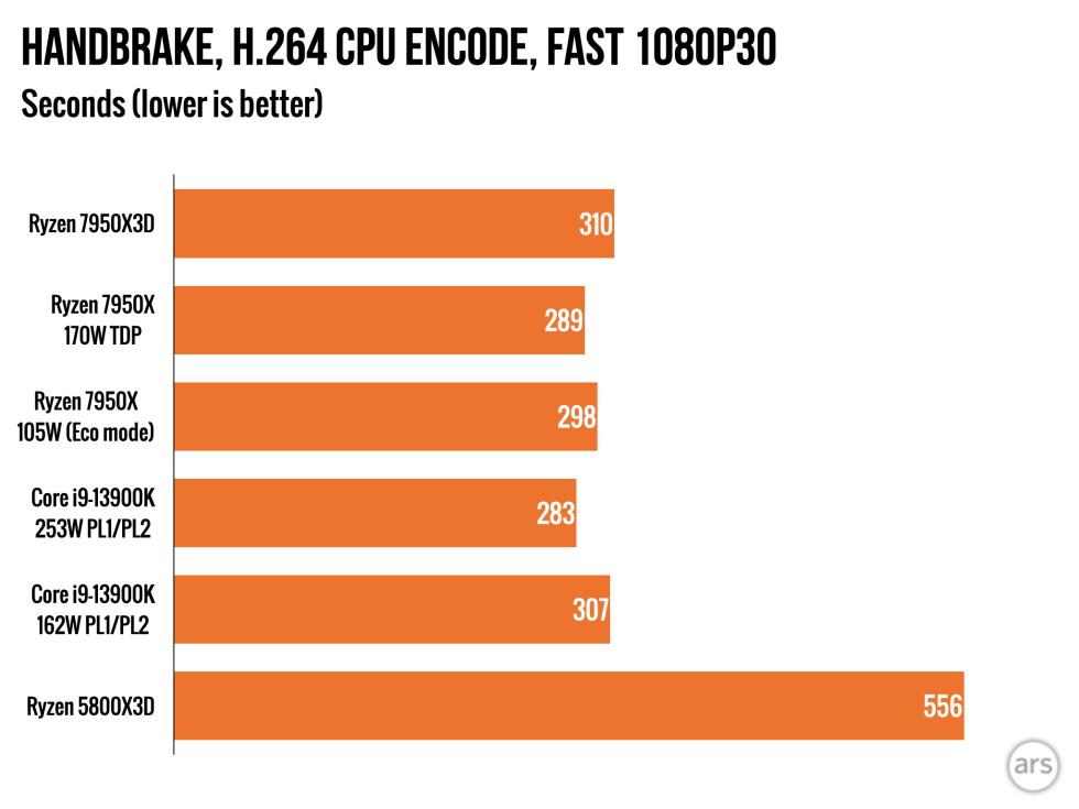

Where did you get that 27% number from w.r.t. Handbrake performance difference between 7950X3D vs 7950X in the Ars technica article? This is what I could find in that article, which does not indicate such a huge performance difference:
Here, the 7950X3D encodes a 4K source video file into 1080p@30 at 124 frames per second, which is the fastest I have ever seen any chip other than an AMD Threadripper accomplish. It is nearly 35% faster than the Intel Core i9-13900K, widely considered the best consumer processor for creatives out there, and 36% faster than the Ryzen 9 7950X. This latter comparison is the most fascinating since it shows very clearly how much that extra cache memory alone can impact performance.

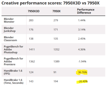

Strange that the results differ so much. That TechRadar article says the Handbrake performance difference is 36.76% between 7950X3D vs 7950X, but the Ars Technica article says there is not that much performance difference at all (but a big difference in energy consumption though).

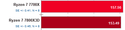

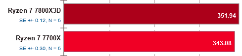

Using DAV1d, 7800X3D with lower 5 GHz boost clock beats 7700X with higher 5.4 GHz boost clock. Overcoming a 400 MHz deficit couldn't be anything other than compute efficiency enhanced by cache, right? Unless the extra 400 MHz is causing the 7700X to throttle really hard.

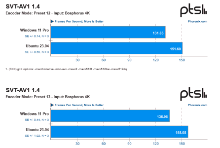

Using SVT-AV1 encoder, the 7700X's higher boost clock is preferred.
Even changing OS may result in crazy performance difference:
Indeed. Waiting for data is the single biggest bottleneck for CPUs. It's not impossible that running at a higher frequency just lets the CPU wait for data more often, and the V-cache can hold said data for specific workloads allowing the CPUs to compute more of its time where without the V-cache it instead has to wait for memory.
So no, more performance doesn't always require higher frequency. It absolutely requires more time spent computing instead waiting, and V-cache can help with that depending on workloads.
