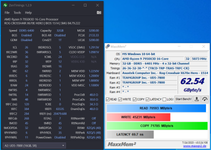

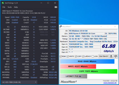

DetOx have you tried this with MaxxMem2?
Yeah but it seems like this program is somewhat buggy.. Will only read the hardware after ive opened and closed the programs 3 times.
And i think its only getting the bandwidth numbers from a single CCD. (Hence 2:1 mode is wasted here since 6400MT/s 1:1 is enough to saturate a single CCD)

I've had problems if TPM is enabled in windows.

Yes, there is definitely bug in this program. If I run 5200CL36 & compare with 6200CL36 on a single CCD (7700), the write speed is literally the same with UCLK=MEMCLK. I've used it with 2 different sets of RAM & not once has it been able to read the major timings on both sets. This app has been around for many yrs already & was last updated in 22'.

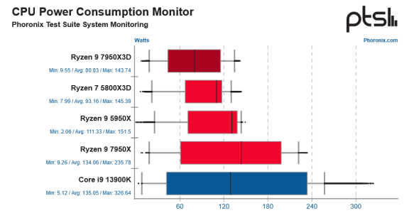

For your particular use cases, 7950X3D all the way.
You can see that 7950X3D wins easily with lowest power consumption and almost similar performance to 7950X. 13900K is just plain bad news for your power bill with the sort of all core workloads you would be doing.

I have found a 7950x without an external GPU will idle around 20watts-ish. Add a GPU and idle CPU watts is over 30 like in the chart above. This is in windows 10.

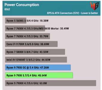

7900 consumes 20W idle, if that will work for you.
It says 22W for 7900 in the article you linked to, but that's just for the CPU as I understand it, not total system idle power consumption? See chart below:
But anyway, going by that chart the difference in idle CPU power consumption seems very small between e.g. 7950X vs 13900K (only 24W vs 21W). So if that chart is accurate, then I guess it must be the accompanying chipset and/or motherboards used for AMD vs Intel that mainly accounts for the higher idle system power consumption on AMD compared to Intel?

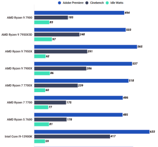

Here, the 7950X idle is only 3 watts higher than 13900K. So I guess yes, it depends on mobo. So if you go with the mobo in this review, 7950X should be your choice. 13900K is again the worst choice ever. 633W watts just for a CPU intensive workload! And the CBR23 figure is more than 100W extra! Yabba dabba YIKES!

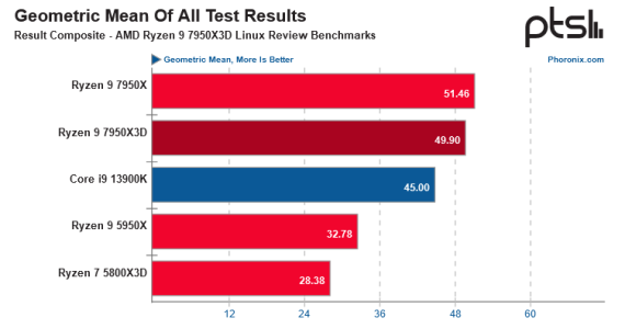

Hmm.... there seems to be different results in different tests.
1. From this one here which igor_kavinski linked to previously, I get the impression that 7950X gets 51.46 and 7950X3D gets 49.90 (so about equally as fast) when both are running at their default power setting (i.e. 7950X3D @ 120W and 7950X @ 170W):
So if the power setting for 7950X is changed from 170W to 142W, I'd assume it'll have lower performance than 7950X3D at 120W?
