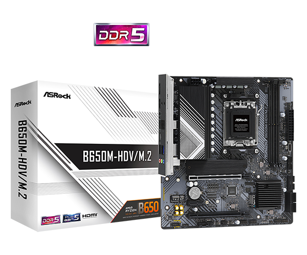

Well, I ordered a shipped and sold by Newegg Ryzen 7600 for $229, 32GB kit of GSkill Flare5 DDR5-6000 CAS30 for $129, a couple of Intel 670p 2TB NVMe drives for $79.99 ea., a couple of EVGA SuperNova P6 Platinum 650W modular PSUs for $129.99 (one for a spare, they were $50 off), and some Antec mid-tower with mesh front.
Oh, and for mobo, I went with the ASRock "HDV" boards. I was all set to go with their (120W) A620 HDV/M.2+, for $99.99, but then I noticed that their B650 board included 2.5gbe LAN for $139.99, which I want if reasonably possible with all of my new builds, as I feel most people will have 2Gbit/sec or better internet in the next two years (enthusiasts).
And today, the Antec N200 is $55 with $5 promo code ($10 less than I paid), and the ASRock B650M-HDV/M.2 is $119.99 ($20 less than I paid.)

HUB review of the ASRock mATX B650 board is up:
Short summary: "Actually really good [for the price]"
-Stock settings enforce a 85C limit for CPU which makes a slight difference in MT performance and VRM temps. But VRMs are still ok with this limit removed and performance within 1% of top boards for the most part. VRM adequate for 7950X with stock limits removed.
-Power on to Windows boot time of 16 seconds
-Echoing my experience with ASRock boards... default XMP/EXPO timings suck. So you will give up gaming performance (few %) here unless you manually tune to at least Buildzoid timings. And their BIOS is bugged for the memclk divider currently (at least on X670E board in my sig) so forget going faster than 6000 MT/s.
-Overall, a solid budget board. Once I can buy a 7800X3D my 7700X in my main rig will be going into a mATX build using this board

Strange Asrock, if you look a little closer, the motherboard does not have any classic connectors for Led lighting.
- 4 Pin 12V RGB
- 3 Pin 5V A-RGB
Blah, even my old Gigabyte B450M S2H has 4 Pin 12V RGB connector.
For a casual comparison, here is the Gigabyte A620 model which has all listed RGB connectors. :mask:
