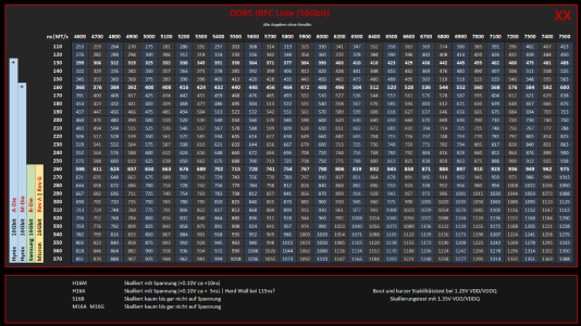

If you're using ASUS boards
vSOC 1.25V
voltage for mem controller / ram 1.35V-1.36V
Overly high vSOC and vMC will actually be less stable
Rest of timings per this post from Buildzoid:

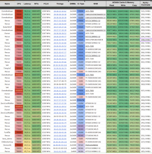

I feel obligated to say something about the Buildzoid timings that are so frequently referenced. I can't speak with personal experience with his Zen 4 timings but I do have relevant experience on the Intel side.
Don't use those timings, seriously. They're overly aggressive, I would say it's overly aggressive even for a 'power' user that wants every possible frame. Certain timings he has listed such as tRefi at 50000 are just asking for data corruption. His listed timing for tRas at 30 is insanely tight for literally zero benefit. You will never notice a difference between a default tRas of 96 and his setting of tRas with a value of 30.
The best DDR5 kit you can buy for Ryzen (by far) is this kit, it's basically overclocked with the EXPO settings out of the box. If you want a 64Gb kit, this is the best you can get, as a bonus it will also perform slightly better than the aforementioned 32Gb kit.
You do know the Zen4 memory controller totally different beast compared to Raptor Lake controller ?
For fully optimized/maxed out memory settings for the current AM5 platform i feel obligated to direct you to this leaderboard where the minimum requirement is 10k coverage in Karhu memory stresstest. (as a performance metric you should be looking at Karhu mb/s)
What buildzoid have posted is the minimum timings garbage bin hynix m-die should run without any problems..
If you really want to extract the maximum memory performance from the AMD DDR5 platform, hynix a-die is recommended as it can run tighter timings (m-die caps out at 150ns tRFC)
