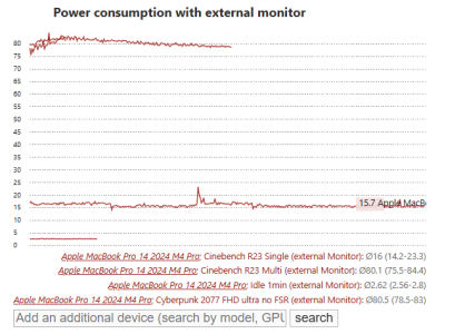

its tested using an external monitor. How is the M4 Pro using 80watts avg here but NBC reported 46 watts peak under load in that earliar article?One has be from wall power and the other a software based reading.
edit: both data is from NBC
I see what you mean.
Let me check. The 79W is under R23. 46W is under R24.
Notebookcheck's Load Average is basically a power virus, meaning full system stress using Prime 95 for CPU and Furmark for GPU.
The Cinebench test is just CPU, so it's only using 46W.
But it’s only testing Cinebench in that chart
