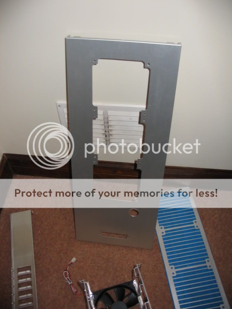

Firstly, we cut the ply jig for the top panel with a jig saw. Using a straight piece of stainless steel clamped to the jig in a workbench, the rough edges were filed down so that they were straight. Then the holes were cut in the jig in the same position as they are on the fan grille using a pillar drill.
This is the finished ply jig.
http://i429.photobucket.com/al...wilson123/IMG_0831.jpg
Next, we drilled the holes for the fan grille in the top panel using the pillar drill.
Then the top panel was screwed between the ply jig and a scrap sacrificial piece of ply using screws screwed through the previously drilled holes.
In addition, a long straight piece of stainless steel was screwed to the main straight cuts on the ply jig as an additional guide for the router.
http://i429.photobucket.com/al...wilson123/IMG_0824.jpg
Next, the top panel / jid assembly was placed on the table router and the cuts made. Note that you will have to complete the cuts in several tries since the amount of saw dust and shavings produced by the router is phenomenal. The dust/shavings have be cleared away several times from the piece.
A photograph after the panel was cut, but whilst it still in the jig:
http://i429.photobucket.com/al...wilson123/IMG_0827.jpg
A photograph of the finished article:
http://i429.photobucket.com/al...wilson123/IMG_0830.jpg
Note that there were no scratches on the outward surfaces of the top panel
I also bought 13x stainless steel M3, 40mm long pan head bolts from a local yacht chandlery (it only cost ~$4). I bought an extra one just in case. Tomorrow 12 of these bolts will have 7mm cut off them, so that when I bolt the rad, fans and fan grille to the top panel, the bolts will not damage the fins on the rad.
Tomorrow, the top panel will be re-clamped between the jig and the piece of ply, so that the 1" hole for the fill port can be drilled. I will re-measure the piece to make sure that it is drilled as close to the rad as possible.
Once the fill port hole has been drilled and the bolts have been cut to the right length, the fabrication will be complete.

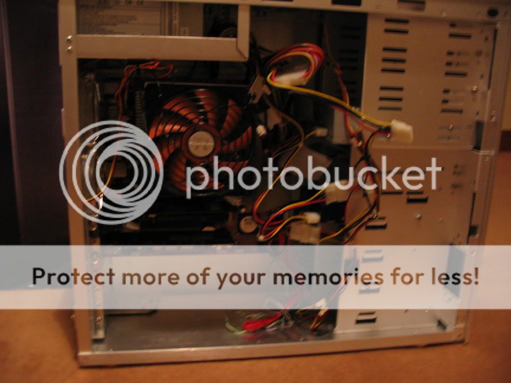

Removed all the components from my "old" new case (CM Praetorian 731 - 3 months old). Re-built my old computer in the Praetorian for my mum (re-used an old floppy disk drive and CD burner - must have left my old DVD burner back at my house). Also replaced the stock AMD HSF with the Big Typ VX120 out of my new computer.
http://i429.photobucket.com/al...wilson123/IMG_0862.jpg

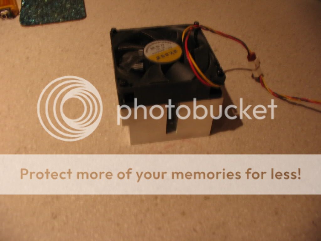

Whilst dis-assembling my new computer I noticed that one of the inner most, central pins was bent upwards in the socket on the MB. I have bent it back a little to its original position using a small needle, however it is not perfect. I think it will be ok since if you push down on the pin then it is perfectly in line with the others, however it does spring back to its bent position when you stop pressing down on it. I think it will be ok because when the CPU presses down on it (and it is locked in position), it should be pressed down to the correct position.
On a side note, look at the difference between the Big Typ shown in the photo above and the stock AMD HSF shown below:
http://i429.photobucket.com/al...wilson123/IMG_0864.jpg

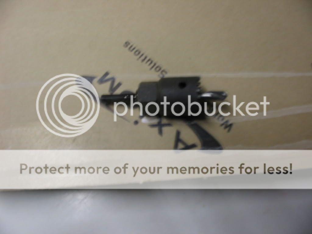

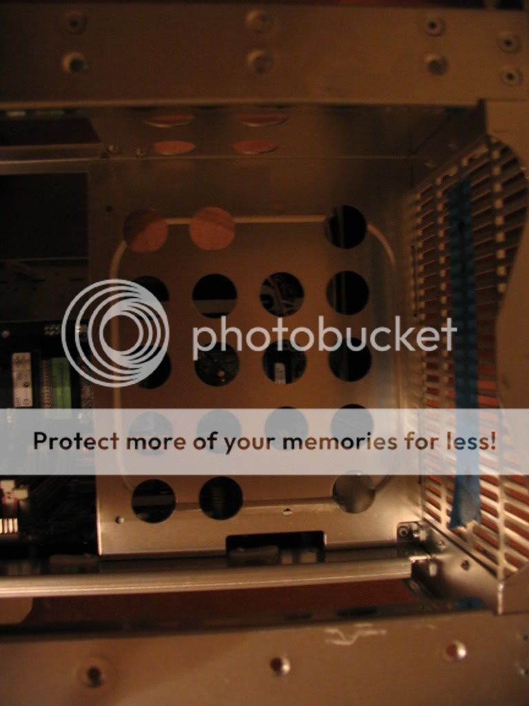

We cut the 1" hole in the Lian li top panel for the fill port using a hole saw. btw this cut the aluminium much cleaner on the pillar drill than the flat drill bit did (we did a test cut on a bit of scrap aluminium using both drill bits). See the below photo, if you don't know what a holesaw looks like.
http://i429.photobucket.com/al...wilson123/IMG_0842.jpg

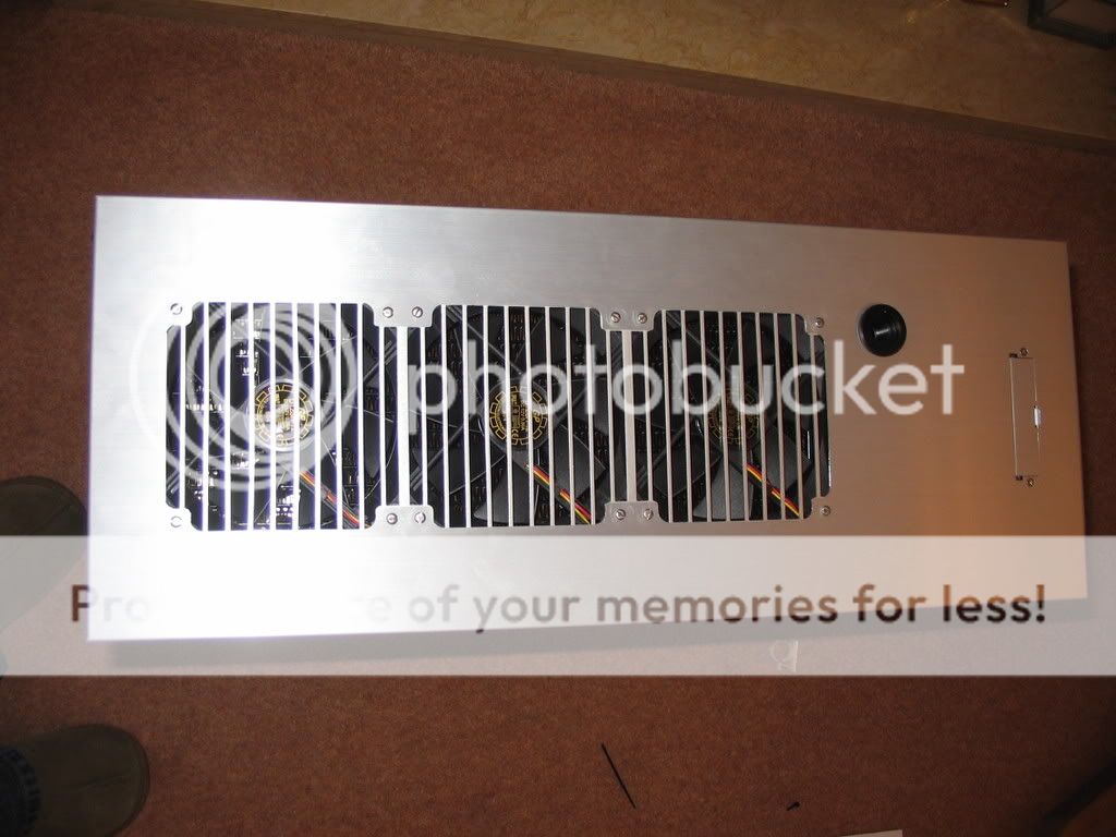

A photo of the finished top panel:
http://i429.photobucket.com/al...wilson123/IMG_0850.jpg

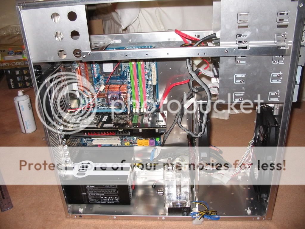

Fitted all the drives and PSU in the Lian Li case. These do not need to be removed again.
Also temporarily fitted the MB, graphics card (HD4870 X2) and pump/res so that I can start routing and cutting the tubing tomorrow (i.e. I have fitted all the large items, so that I can work the tubing around them). See the below photos.
http://i429.photobucket.com/al...wilson123/IMG_0858.jpg
http://i429.photobucket.com/al...wilson123/IMG_0859.jpg

I will upload a photo of the two test holes in the scrap bit of aluminium. One is significantly better than the other.

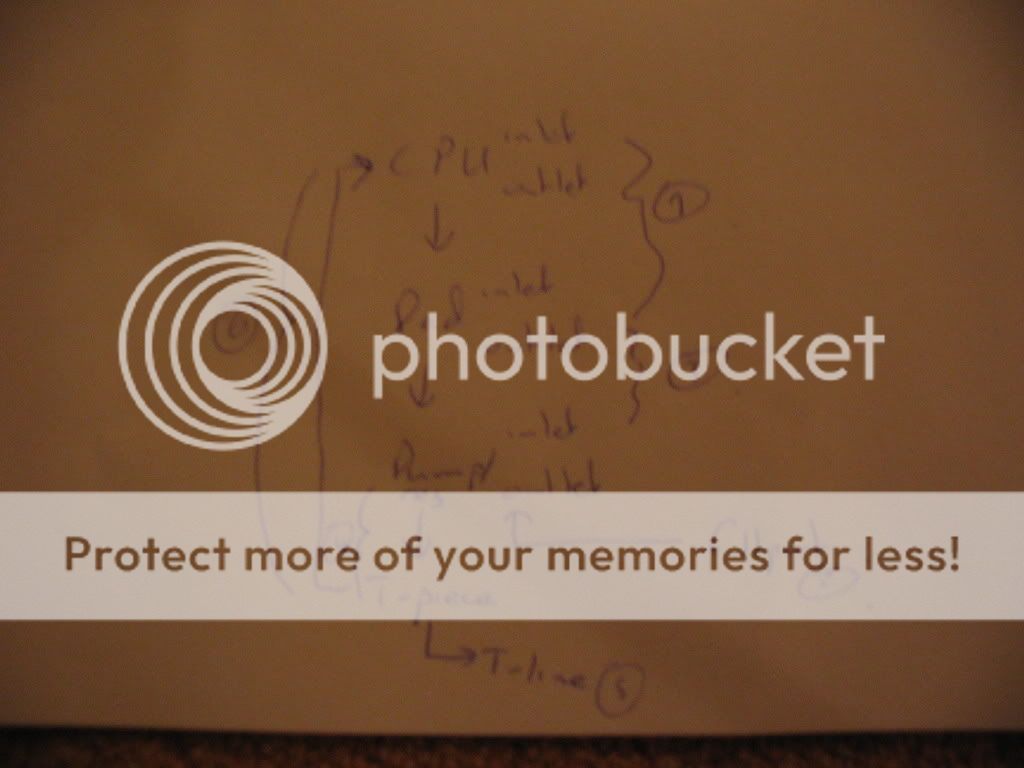

Cut tubing to length, labelling each piece for assembly outside the case. Drew a diagram referencing all the tubing (see below).

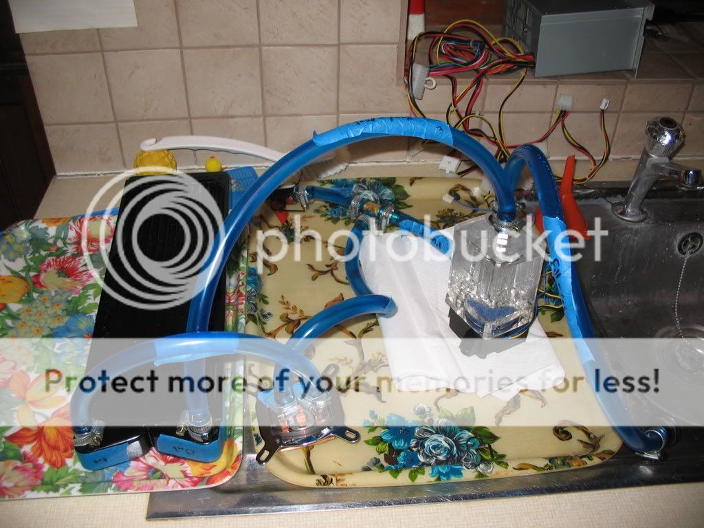

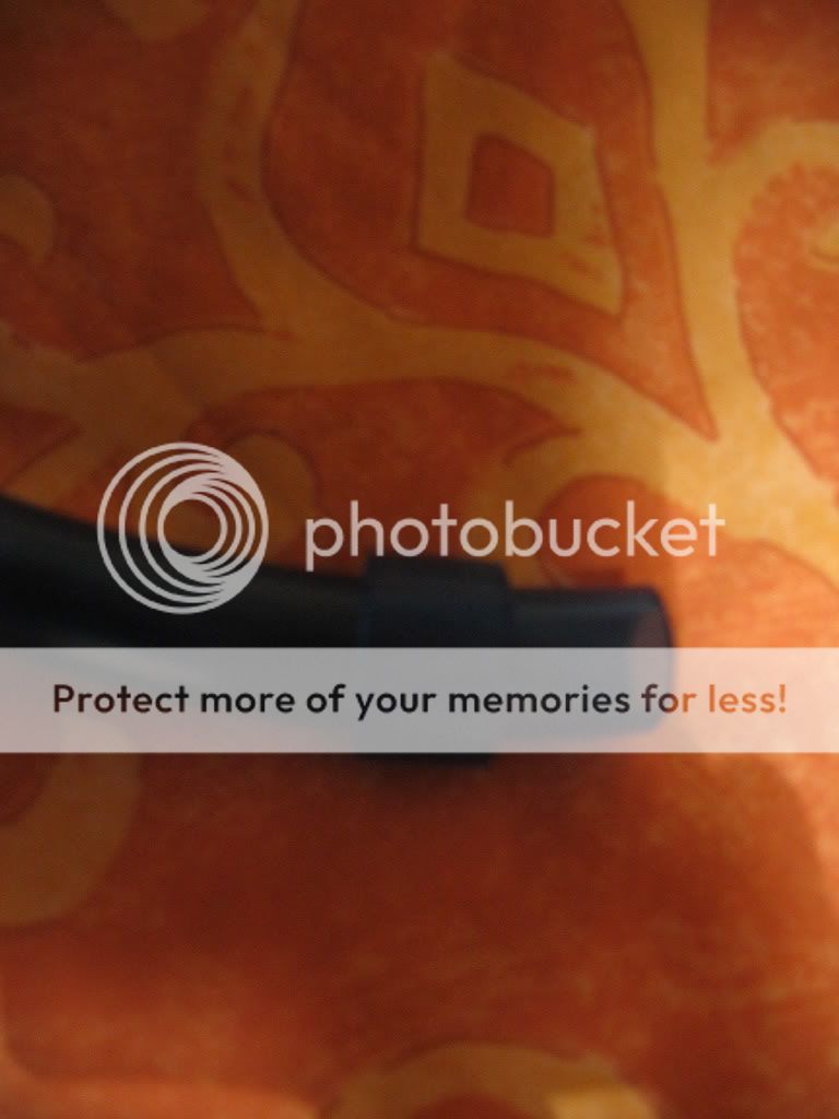

I assembled the loop oustide the case. btw, tightening up the hose clamps, whilst keeping them in position over the barb/tubing hurts your fingers. Pre-tightened the hose clamps befrorehand, so that it was slightly larger ID than the OD of the tubing on the barb. This helped relieve the hassle (and my fingers) of having to them tighten all the way once they were positioned on the barb/tubing.
I also found that the barbs loosened once I had put the tubing/clamps on. This was despite tightenening all the barbs by a 1/2 turn beyond finger tight beforehand. Re-tightened all the barbs, and double checked that they were all tight.

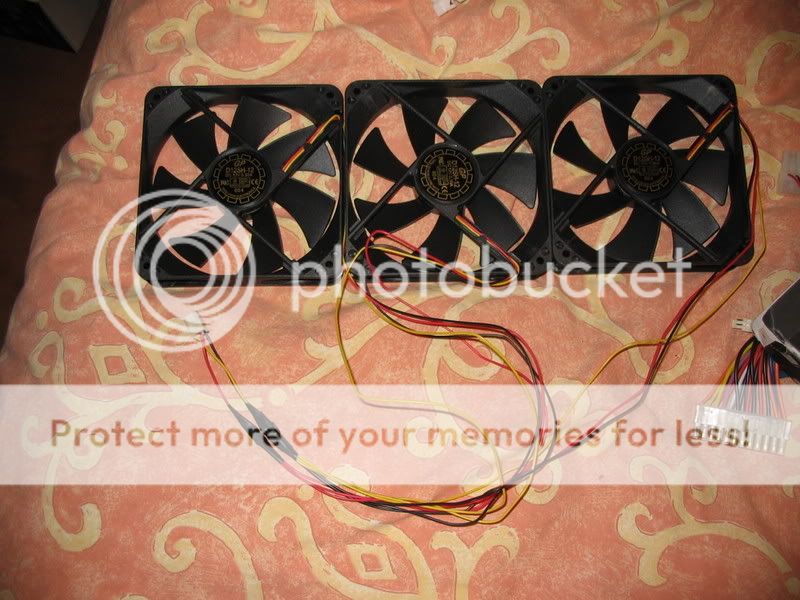

Cut the cabling on the 3x Yate Loon fans. Soldered the cables together, so that they were on one 3-pin connector. Wrapped soldered connections with electrical tape (its not pretty, I know, but it does the job). See the photo below.
http://i429.photobucket.com/al...wilson123/IMG_0868.jpg
btw It has been 10 years since I lasted used a soldering iron, so I was a bit rusty and I'm sure with practice I could have done a better job.
Tested the 3x fans on the hot-wired PSU, using a molex to 3-pin adapter, to check that they all worked.
Bench-tested the loop using the hot-wired PSU; it's alive 🙂 and no leaks. I used just distlled water for the bench test. I will use the PT Nuke (biocide) and anti-corrosive additives, once the loop is installed in the case tomorrow. See the below photo for the bench test.
http://i429.photobucket.com/al...wilson123/IMG_0867.jpg
btw the pump is noisy for about 10 minutes and you have to top up the res a few times, whilst the air bleeds out of the system. Jiggle each component a bit to help get the air out.
Once the loop is bled, the pump becomes quiet.
It has been running for almost 2 hours without incident. I will keep an eye on it during the bench test. I will run the bench test for about 12 hours (I can't run it for 24 hours due to time constraints).

On your fans only one fan gets the yellow connected, these are rpm sense wires.
Thanks for the info Woodbutcher. It won't make a difference at this point, since I'm going to connect it directly to the PSU via a 3-pin to molex adapter.
When I get the fan controller, I will sort out the wiring to the fans. To do this, do I just cut the yellow cables from two of the fans?
Edit: @ Woodbutcher and/or Aigo. What do you guys think of what I've done so far; are there any obvious mistakes?

Yes, cut or disconnect all but one of the yellow wires in a flock of fans. One fan will be representative of the group. Even without the fan control you still have the option of 12 or 5 volts at the molex . Swap the pins in the fan side of the 4 pin molex to connect to the 5 rather than the 12.

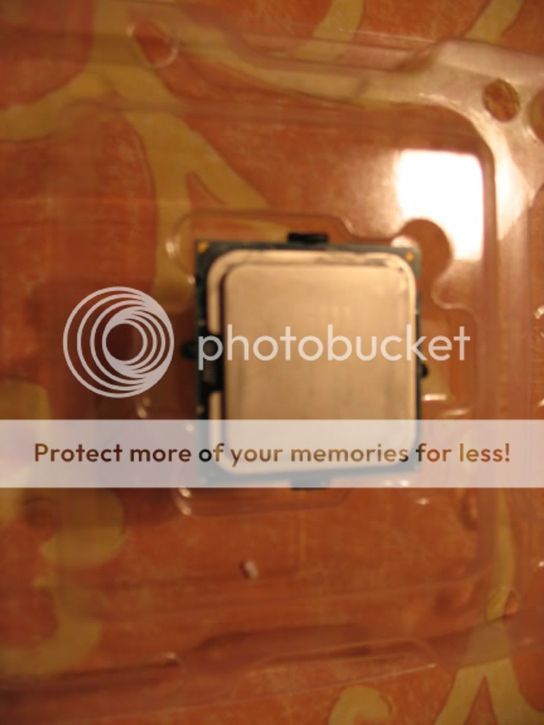

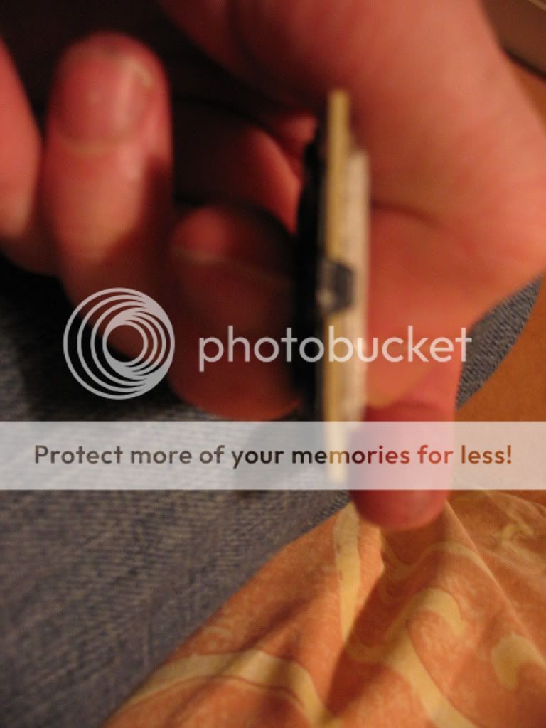

I was cleaning the heat spreader on the chip prior to installation in the MB and it fell out of the protective cover on to the floor. Lots of expletives later...
The drop slightly bent one corner of the processor. See the photo below:
http://i429.photobucket.com/al...wilson123/IMG_0892.jpg
You can just about see the bend in the photo above.

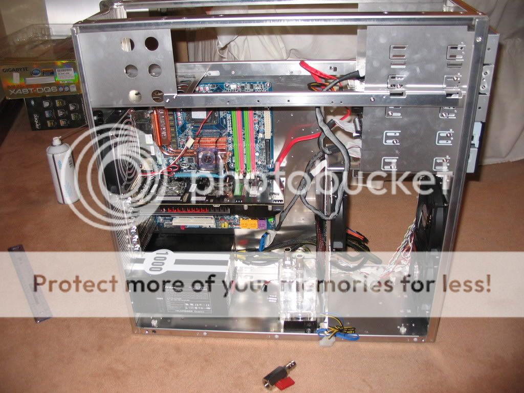

I re-built the case with the liquid cooling system, switched the system on and after a couple of seconds it switched itself back off. Here's some photos:
http://i429.photobucket.com/al...wilson123/IMG_0885.jpg
http://i429.photobucket.com/al...wilson123/IMG_0886.jpg
Oh' and my dad also dropped the fill port on the MB, which probably didn't help (although I couldn't see any damage). The Wilson family must be blessed with butter fingers.
Checked all the wiring in the case / MB and it was all ok.
I removed the CPU block and CPU for further examination.
Upon further examination, I noted that the top of the CPU had a hairline crack across where it had bent.
One expensive key-chain:
