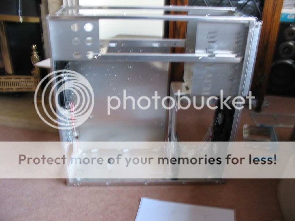

So work on the liquid cooling in my new Lian Li A70A case started today.
First off, all the non-essential stuff (3.5" bay cage, top 3.5" bay and fan module and VGA card pillar) were removed from the case:
http://i429.photobucket.com/al...wilson123/IMG_0813.jpg
Woodbutcher - the VGA card pillar does not seem to provide and structural benefit, so it will be permenantly removed.
After a lot of measuring and re-measuring we decided where all the liquid cooling components are going to go. We marked on where the rad and fan grille will be positioned on the backside of the top panel. I also covered the top panel in thick paper and masking tape to protect the brushed aluminium finish.
http://i429.photobucket.com/al...wilson123/IMG_0815.jpg

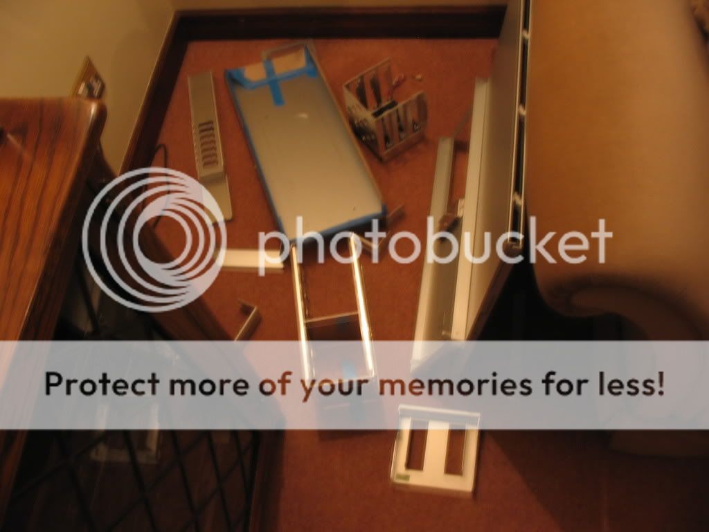

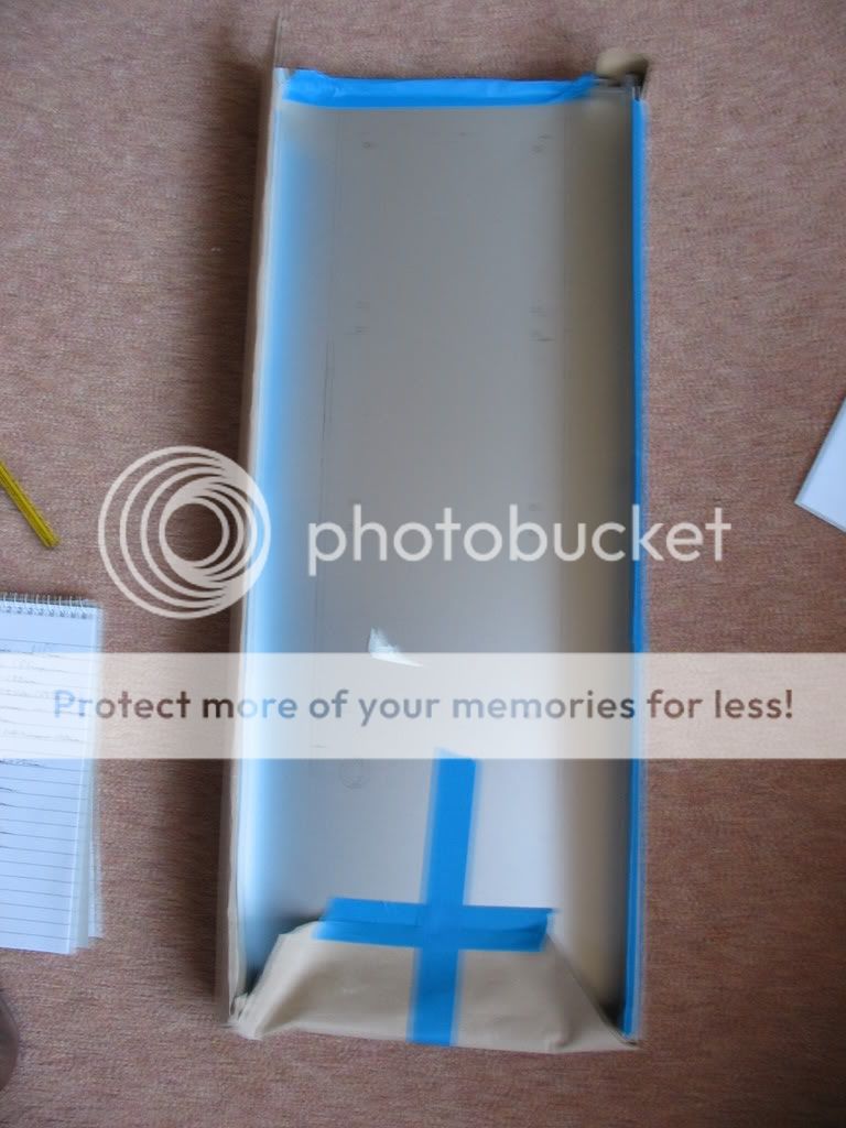

Next was removing the side, top and front panels, so that the case was stripped down to the chassis:
http://i429.photobucket.com/al...wilson123/IMG_0814.jpg
All the bits I removed from the case - quite a few:
http://i429.photobucket.com/al...wilson123/IMG_0817.jpg

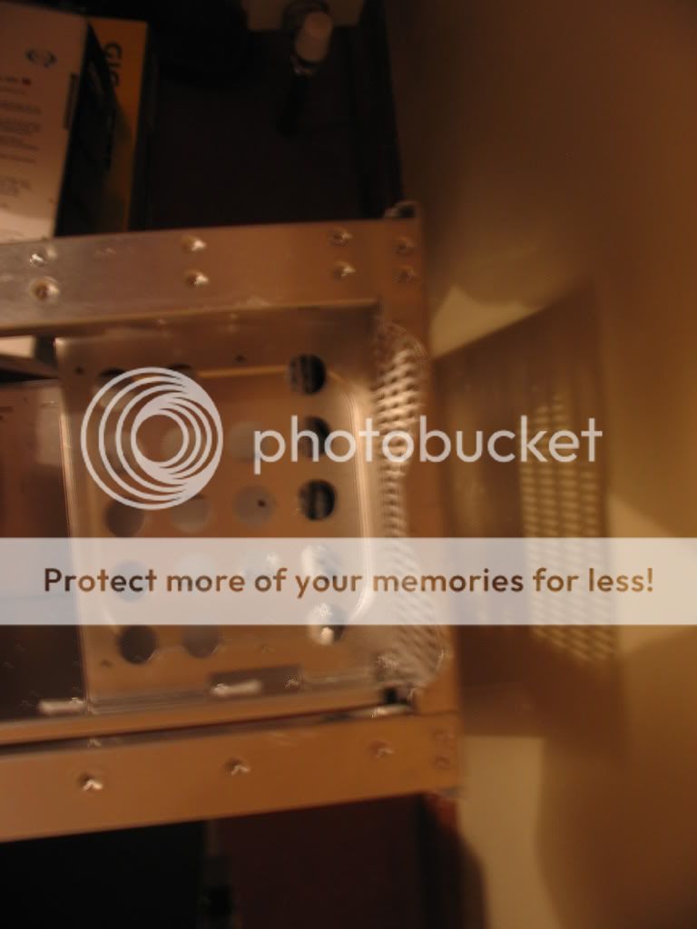

Using a jigsaw and files, I cut two notches in the top rear flange of the chassis to accommodate the inlet and outlet on the rad:
http://i429.photobucket.com/al...wilson123/IMG_0823.jpg
Basically the rad will be fitted so that the front of it lines up perfectly with the back of the 5.25" front bays (it can't move back any further than this).
I decided to bolt the res/pump directly to the bottom of the case (I was persuaded by my dad). I drilled the mounting holes for the pump in the case.
Drew a template of the inner layout of the fan grille on a piece of paper and transfered this to 6mm thick ply using a Stanley knife:
http://i429.photobucket.com/al...wilson123/IMG_0819.jpg
This will be the jig for cutting the hole in the top panel for the rad and rad grille.
We will cut this jig out on the router table using a stainless steel guide (for the main straight cuts), a jigsaw for the corner cuts and a dremel to tidy up any raggy edges.
Note that the quality of the jig will reflect the quality of the cut to the top panel.
We have also drilled two of the bolt holes for the fan grille in the top panel using a table pillar drill. These bolt holes will be used as a guide to drill the other 10No. fan grille holes. The top panel will be sandwiched between the ply jig and a sacrificial piece of wood. The fan grille hole in the top panel will be cut on the router table (with a straight edge bit and ball bearing).
btw the bolts that ChilledPCs sent me for the fan grille do not fit the rad, although I also bought the rad from them (wtf): they are too short and the wrong size. The bolts supplied with the rad are also too short. I will be buying 12x stainless steel M3, 40mm long pan head bolts from a local yacht chandlery tomorrow morning (and will probably cost me about $30). The bolts will be ground down to 34mm so that they don't puncher the fins on the rad.
The lian li 3.5" to 5.25" floppy disk drive bay adapter turned up today, so I now have all the components.
