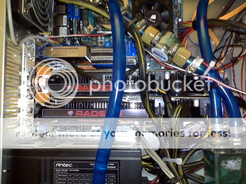

1. Second HD 4870 X2 is installed and seems to be working. I am going to update to the latest Win 7 RC ATI CCC drivers released last week.
Quad-fire goodness: http://i429.photobucket.com/al...wilson123/IMG00031.jpg
What a PITA it was negotiating the damn card around the tubing and cabling. Managed to do it though, with a little gentle persuasion (club hammer j/k). I hope this card never fails because it will be b*stard trying to remove it.

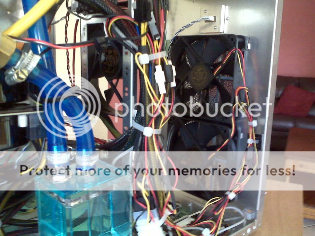

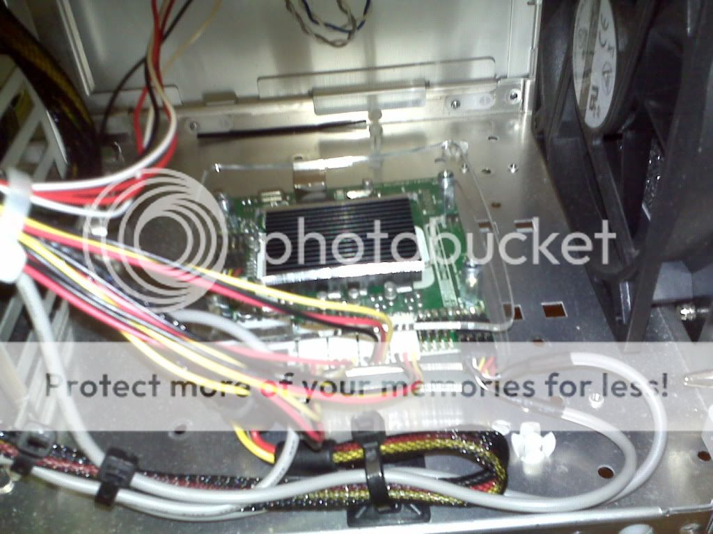

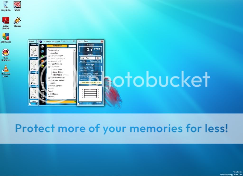

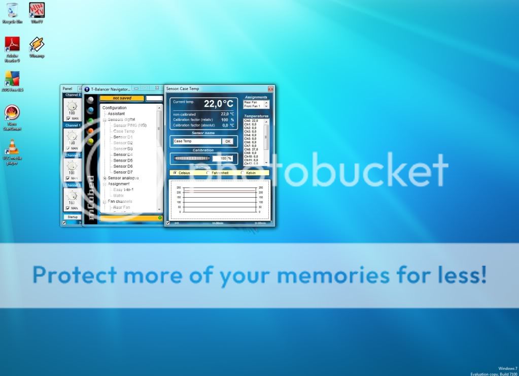

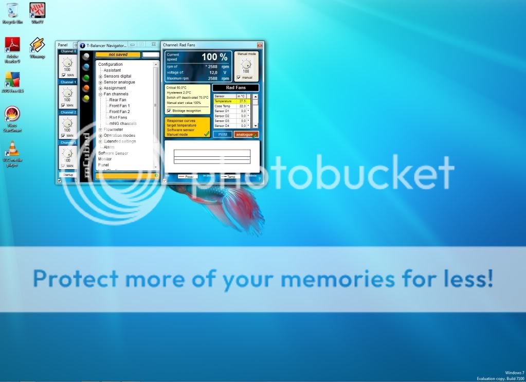

2. Disconnected the rad fans from the PSU and the case fans connected to the MB and reconnected the whole lot to the M Cubed TBalancer. I can now control all the fans from the TBalancer S/W. Note that I used fan extension cables on every fan.
TBalancer inside the case: http://i429.photobucket.com/al...wilson123/IMG00030.jpg
Case temperature: http://i429.photobucket.com/al.../TBalancerCaseTemp.jpg
Rad Fans: http://i429.photobucket.com/al...n123/TBalancerFans.jpg
Flow meter: http://i429.photobucket.com/al...n123/TBalancerFlow.jpg

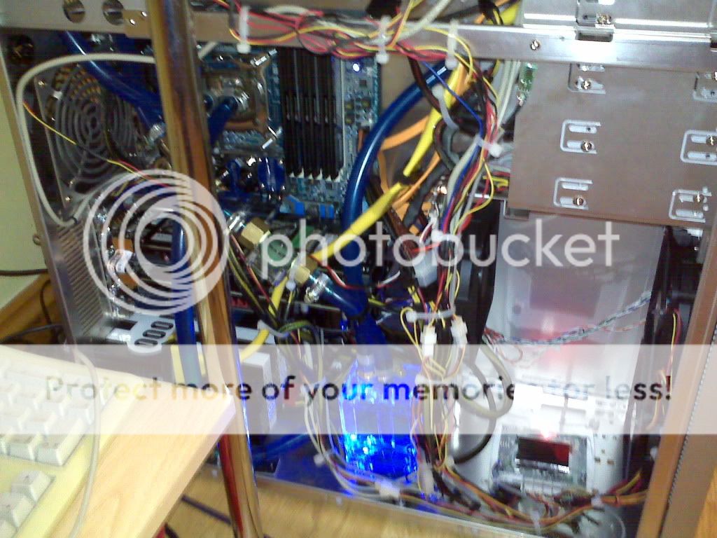

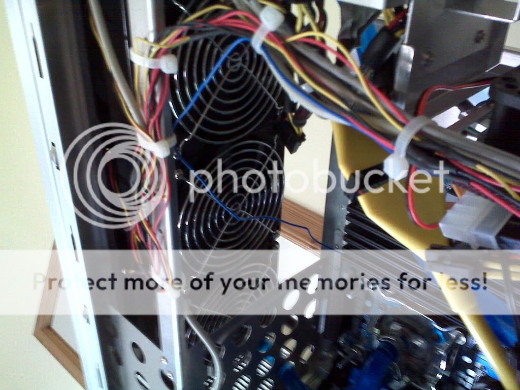

3. The above involved re-routing a few cables.
General inside case photo: http://i429.photobucket.com/al...wilson123/IMG00028.jpg
4. I got rid of the electrical tape wrapped around the soldered connections for the 3x rad fans to single fan connector. Instead used proper heat shrink.

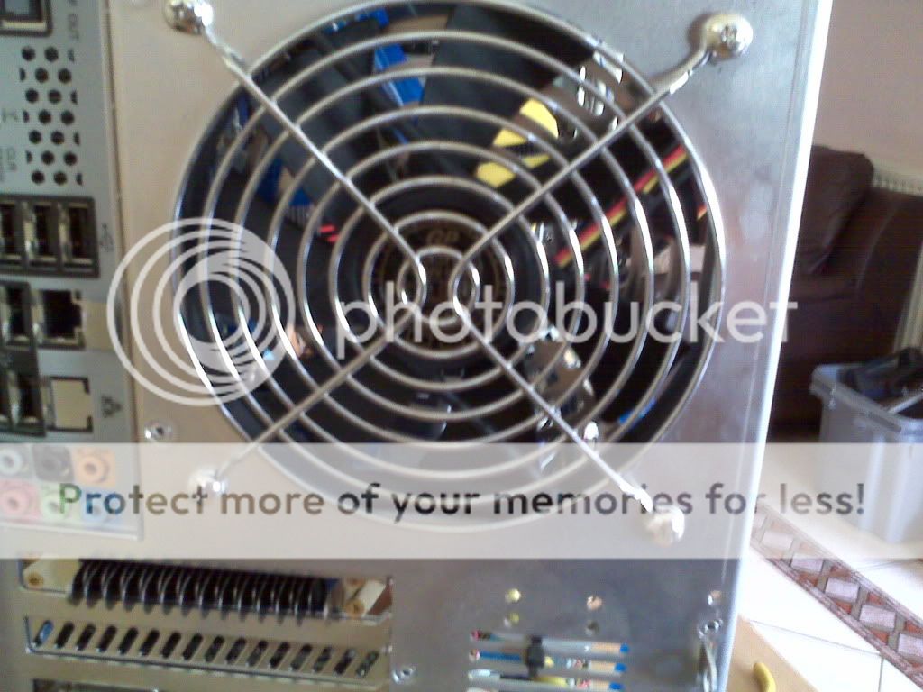

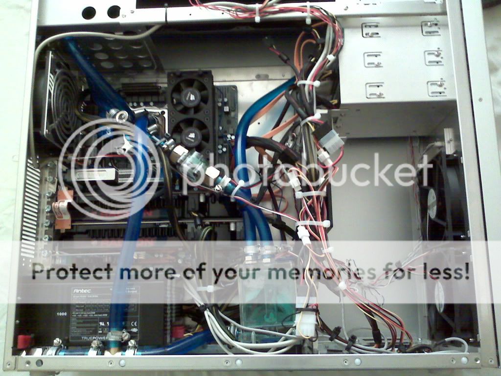

All the case fans have been replaced with Yate Loon D12SH-12 fans and I fitted 3 additional Yate Loon fans to the underside of the rad for a push-pull config (and I managed to fit all four bolts into the fan nearest the rear).
I fitted the FDD cable and the floppy disk drive works. I've also tidied up the cable managmenet a little (it's still pretty poor though, but good enough for me).
All fans except for the one in the centre are connected to and can be controlled by the TBalancer fan controller.
Here's some pics:
http://i429.photobucket.com/al...wilson123/IMG00042.jpg
http://i429.photobucket.com/al...wilson123/IMG00044.jpg
http://i429.photobucket.com/al...wilson123/IMG00045.jpg
http://i429.photobucket.com/al...wilson123/IMG00046.jpg
I don't know if the temps have improved since I am leaving the side panel off and I have removed the RAM cooler, so I can swap out the RAM to RMA it.
Once, I get and install the replacement RAM and fit the fan cooler, this build is finished.
