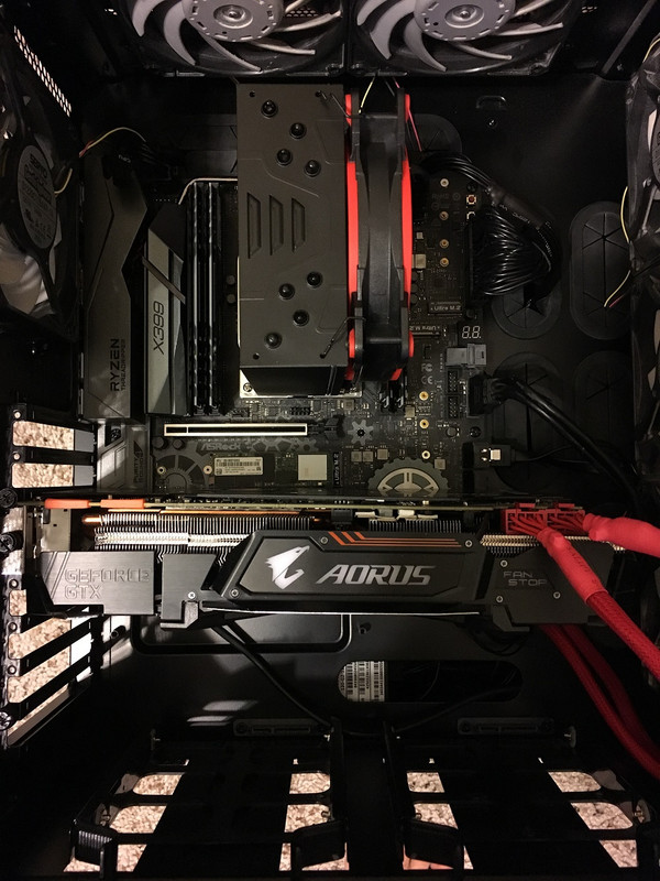

Hi guys
After reading for about a year, I've finally built my threadripper system.
I was playing a little with idea of going with 2990WX but I would have probably never used it at its full potential and it's too expensive anyway.
I got
2950X,
2X G.SKILL TridentZ 16GB 2x8GB 3600MHz DDR4 CL15-15-15
Gigabyte X399 AORUS XTREME
Noctua NH U14S TR4-SP3 - Noctua
Samsung 970 Evo M.2 500GB
NVIDIA 1080
I've chosen gigabyte because I got badly burned with ASUS (twice), MSI doesn't ring my bell, and ASROCk was currently unavailable (at least in my country). Gigabyte low - middle range boards almost always were "plug and play" for me. I was a little afraid because there is little information about this boards on forums, and oficial reviews nowadays are a "little" vague. For example almost every review site goes about how close distances between super IO armor and memory slots are. TridentZ fit there with with like a two milimeters gap. Same goes with CPU cooling - but if wanted all 8 dimms I would have to find another cooling solution. The board itself is pretty well made, and building a system went like a charm (succesful boot on the first time), but BIOS is ... Let's just say it is there. Orange letters on the dark background are horrible enough. The information is scattered in submenus, settings are unintuitive.For example: you've got some setting set auto. Click it and nothing happens. You have to start writing and finally some values appear. I could go on but I'm not writing a review here :)
Given how unclear tr4 cooling situation is I went with Noctua. I would love to get AIO but... Custom WC - I don't have time, skill and I'm not sure if I'm willing to experiment on such a rig. Been building system for a few years now (those 300A's :)) but had never touched anything wet yet (computers wise):) I'll wait a little maybe there will be some AIO wich doesn't destroy itself. Was thinking about thermalright Silver arrow but I couldn't find direct comparison with noctua and it wasn't available.
I'm little worried about my voltages on auto. I don't plan to OC I just want productivity and longevity. If I set auto in ryzen master I get big voltage spikes. VID 1.550, soc voltage 1.100, cpu core voltage 1.537 and vcore 1.476 seem a little bit high. I couldn't find any official guidelines on threadripper 2 but everybody seems to agree that original threadripper safe limit is 1.450V. I know Vid voltages doesn't mean much but vcore is a little too high for me. If set manual I can get 4ghz@1.275V (hwinfo 1.308V) which seems stable and reasonable.
