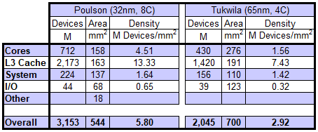

How we can know density if we don't know the number of transistor either..,
Also, it is not said that AMD and Nvidia count their transistors in the same way.
leoneazzurro
Jul 26, 2016
1,114
1,867
How many ways of counting transistors are there?
A lot
It depends of what you are actually counting, only functional units as schematics or actual implementation, and for which type of circuitry.
In this article is explicitly stated that, for the same design, the "transistor count" may vary, according to what the producer actually counts, as much as 33-37%
