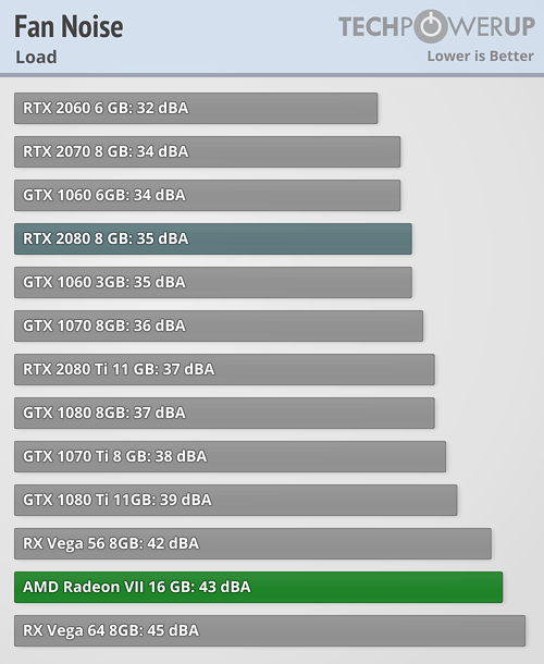

The one thing I do not like about the similarity is that it was a very noisy cooler cofirmed by both:

and Techpowerup
Gaming noise levels are just way too high; the fans ramp up very quickly and become a nuisance mere seconds after putting some gaming load on the card. If you compare this to NVIDIA's offerings, it'll be a day-and-night difference! If you value low noise, the Radeon VII is definitely not for you.
A 8-9 dbA difference compared to a 2080 and ~6 dBA compared to a 2080 Ti. As the decibel scale is logarithmicm that's nearly 10x noisier.
Overall I really hope they have improved upon the cooler and don't need as agressive ramp-up.

and Techpowerup
Fans are larger, though, with bigger blades. Also, we don't know about rotational speed. Even if the design is similar, noise cannot be determined by looking at an older card.
