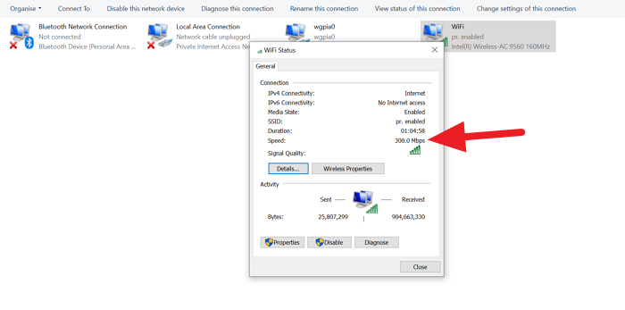

Ok, I've just installed a brand new router but I'm facing the same issue.

So, the cable & router have been swapped which leaves the NIC. If the NIC isn't gigabit then that explains the 100mbps link but, if it is gigabit then there's some issue with it whether physical or driver.

In Device Manager, advanced settings for the NIC, try forcing the link speed. I'd start with 10 full and work up.
I've seen an issue occasionally with certain NICs and "gigabit capable" routers whereby if the NIC links automatically at 1gbps then the actual throughput is rubbish. Force it to 100 full and it works exactly as it should.

If you look at mxnerd post #6 it indicate 1GB connection.
Tech J boast with 5G connection.
This speed sare not the real speed of the flow in the Network, they are the teoretical capacity of the Network card.
Your card indicate (post #9) 100Mb/sec. I.e., 10 times slower than MX and 50 time then Tech.
So. configure correctly the Network's cards (wire and wireless) on your computer and make sure that it say there at least 1GB.
