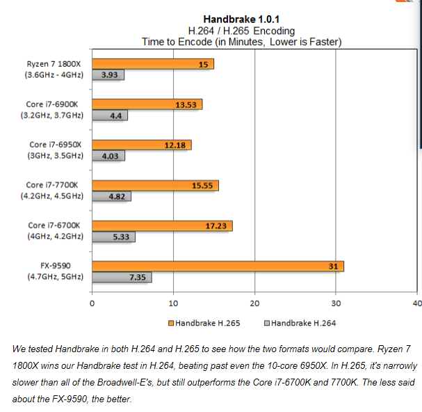

What are you talking about? I don't think you follow the development of h264 encoders as well as you think you do. x264 already has been utilizing avx2 and x264's ability to use more threads has been improved some few times in the last couple or few years.
x264 is one of, if not the most, worked on video encoder and it's staying power is pretty immense. 265 has a long way to go to improve on everything x264 already has BEEN doing. There's not a lot of advantage in even using 265, yet, and 265 is SLOW.
Well I'm far from an expert on this subject, but I do read the doom9 forums and that's where I got it from. That said, I NEVER said at any point that x264 didn't utilize AVX2, or couldn't use multithreading. I just said that its ability to utilize them was limited, especially compared to X265. But you don't have to take my word for it, just look at the benchmarks that I've posted which demonstrate it perfectly:
The largest performance increase stems from AVX2 implementation and efficiency. I mean, just look at the FX-9590. It's obliterated under H265, because it lacks AVX2. Under H264 though, it's still competitive more or less.
The Ryzen which has half the AVX2 throughput of the Intel CPUs goes from winning in H264, to being behind the 6900K and 6950X with H265. And a longer test would magnify these margins even more.
Fact is, H265 even at this stage has a much heavier integration of AVX2 than H264, and slightly better multithreading support. This will continue to improve though as time goes by. Relatively speaking, it's still in the early stages of optimization.

True, but as tamz_msc mentioned new version of AIDA shows different results. Also double sized L2 comparing Intel gives AMD some advantage. However, the biggest drawback with Zen is its CCX specific L3 cache as only 8MB can be used per CCX. If one core would need the whole cache, it would be forced to use Infinity Fabric for reaching the whole L3, which is fast, but way slower than the normal Lx cache requests. I assume that somewhere here is also the reason why we haven't seen 4+2 or 4+0 CCX combinations yet eg. 1500X have four cores (could fit to one CCX) but 16MB L3. Still wondering why the 4c variants with 8MB L3 are not using only one CCX, but maybe it has something to do with the Infinity Fabric, yields...only AMD knows.
AIDA64 measures exactly half the L1 bandwidth of the 6900K on the Ryzen 8-core, which is expected. However, the L2 and L3 bandwidth as measured properly by the newest version is vastly superior on Ryzen.
Most of the latency issues seem to stem from the inter-CCX penalty more than anything else.
@ sushukka and tamz_msc, I think you've got it wrong for the L2 and L3 cache in Intel CPUs versus the Ryzen processors. From what I've read, the L2 cache in Intel CPUs basically just feed the L1 instruction cache and help mitigate cache misses along with the branch predictors. The L3 cache in Intel CPUs doesn't even run at the speed of the cores. I think Intel uses it for inter-core communication, and to buffer the L2 cache. So from this perspective, it makes sense for Intel to have the fastest and most accurate L1 cache they can design to feed their 256 bit operations, and significantly slower but larger L2 and L3 caches.
I don't know if it works the same way in Ryzen CPUs though.
I think your last sentence supports the opposing argument of the first two-thirds of your paragraph as well. None of us going into launch, if you had been following the info anyway, should be surprised much by Ryzen's AVX2 performance. Once details came out about how AVX2 would run on it, we could guess how it would perform relative to the rest of the chip. As you said, it's early in the optimization game. Things are subject to change on both sides of the fence.
https://bitbucket.org/multicoreware...389bda8a63f5f7d/source/common/x86/?at=default
The ASM source here is directly pulled from the x264 project with two
changes:
1 - FENC_STRIDE must be increased to 64 in x86util.asm because of HEVC's
larger CU sizes
2 - Because of #1, we must rebrand the functions with x265_ prefixes in
x86inc.asm (private_prefix) and pixel-a.asm (mangle(x265_pixel_ssd))
3 - We have modified the MMX SSD primitives to use EMMS before returning
4 - We have added some new SATD block sizes for SSE3
Current assembly is based on x264 revision:
configure: Support cygwin64
Diogo Franco (Kovensky) <diogomfranco@gmail.com>
2013-07-23 22:17:44 -0300
It's almost all mmx to ss3. The biggest change from 264 to 265 is the increase of block size to 64.
The big caches on intel most likely lend themselves to this. If any AVX is used it is done so by the compiler in the c++ code.
