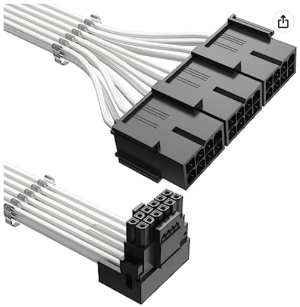

Interesting. The recent spike in adapter failures all seem to be Cable mod related. Which happens to be the only adapter that features 2 x 16-pin connecting points (M/F), thus doubling its resistance points and fail potential. If any weak connecting point on either side, it will draw more power, heat and of course melt. As demonstrated by the guy in comments saying his failed adapter was where the PSU cable joins to it (see below):
P.S. this does not mean that I think the 12vPHR connector is not a poor design, it is and needs to change to prevent any such occurrences no matter how small in number from occurring. And to ensure no manufacturing variances come into play that may cause any potential failures.
