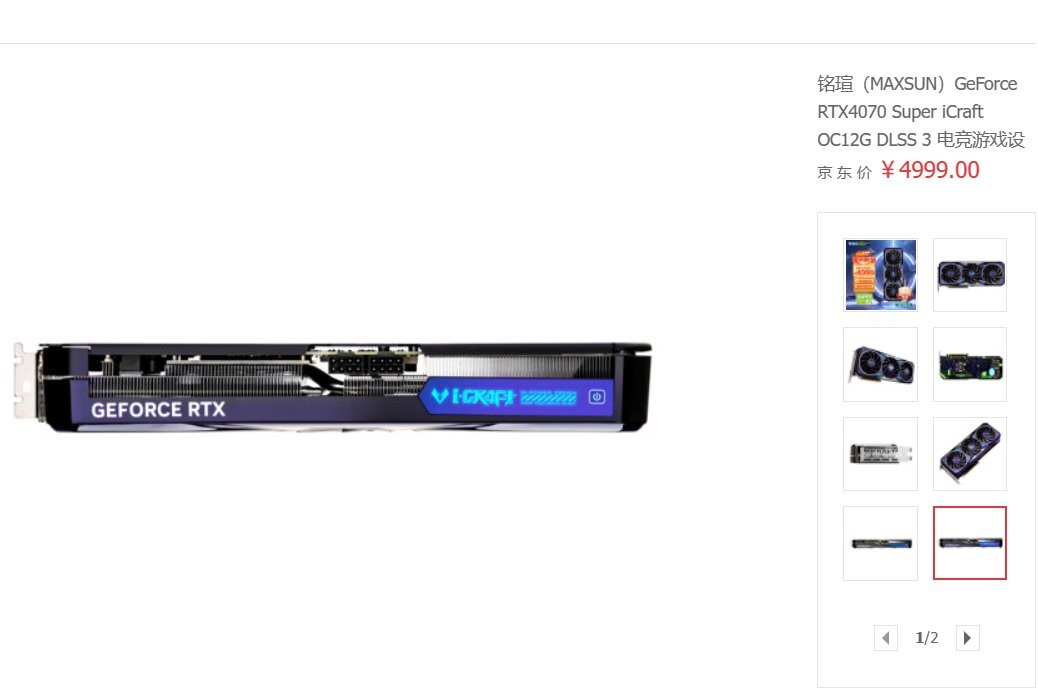

Maxsun gives the middle finger to 12VHPWR.
