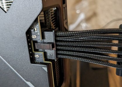

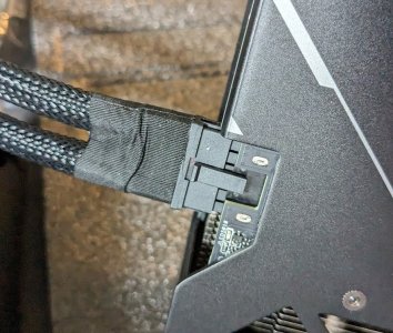

Amazon brought the cable much faster than I thought, some photos below. Conclusion is that the NVIDIA-provided adapter must have been out of spec. The corsair one fits just fine.
Photos compare insertion with approximately the same amount of force applied to the cable. No amount of force will make the NVIDIA one that came in the ASUS box go all the way in. Pretty sure the pins would fail in shear before you could seat it.
Seems like a good way to cook a RTX 4090 if the user doesn't already know this is a problem...

Glad you got it sorted out and in the process, helped provide a solution to anyone else here who would've faced the same issue.
Oh don't worry, certain NV public defenders on the internet will be quick to point out it's "user error". o_O
You should save that faulty cable, in case gamersnexus or jayz2cents want to buy it off you.
