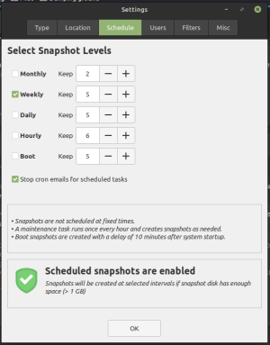

Huh? While Timeshift is installed by default I don't think it's enabled in any way. IIRC I had to go in and define a schedule. In Timeshift's settings, I enabled a schedule of 5 weeks worth of backups to be kept.
As I did not knew exactly how it worked and how much storage it would use, mint recommends it being enabled in some form. Do you use hourly, daily, weekly or boot Timeshift images and how many?
I think the 'weekly' tickbox and accompanying number is literally the only setting I've changed in Timeshift.
