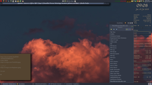

My desktop is always the same. I first started with ubuntu using gnome2. I thought it was an amazing setup for a desktop, and I still do. It's a two panel system. Top panel has some quick launchers, access to the system, and informational widgets. Bottom panel is a task switcher. Screenshot is xfce. My plasma setup at work is largely the same. In the past, I played around with enlightenment a fair amount, and it too was setup the same way. If a desktop couldn't be setup this way for some reason, it's an immediate dismissal. I won't entertain any other setup aside from a special purpose computer.

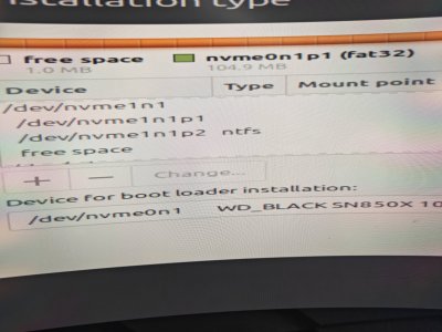

So, I finally decided to try to install Mint but had to give up during installation as it all became too complicated. Obviously, I couldn't just choose regular install, so very quickly I got confused to have to create different partitions to /, /home, /swap and where to place bootloader etc. very confusing.
The only required partitions are / and swap, and maybe not even swap. Some are going with swap files a la windows, and that makes sense to me, but I don't know specifically how to make one. Last time I did an install, swap partitions were standard, so that's what I used.

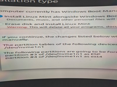

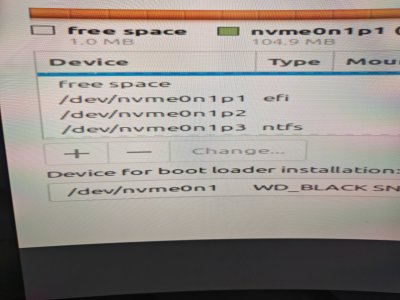

1000012150.jpg1000012151.jpg1000012152.jpgMaybe I should just choose install alongside windows, as it seems to choose the correct drive for installation?
Nvme0 being my Windows drive and Nvme1 being my new SSD.
I'm having a hard time making out the screenshots, and it's been awhile since I did an install, so it isn't clear in my head without sitting there looking at it.
There's a bunch of ways to do this, with many scenarios. Going back to my first(I think) post, I mentioned pulling your windows drive before install keeping everything ignorant of what's installed. That's the most clearcut for installing, and foolproof as far as causing lasting damage goes, but it makes selecting an o/s at boot more of a hassle, though that can be simplified by letting linux handle everything, and leaving windows ignorant.
What's your ideal situation? Keeping o/ss on one drive, and using the second as a data drive has some appeal, but I don't like the idea of linux using ntfs. Everything works fine with that ime, but I suspect it's suboptimal for speed and robustness since it isn't native linux tech :shrugs:

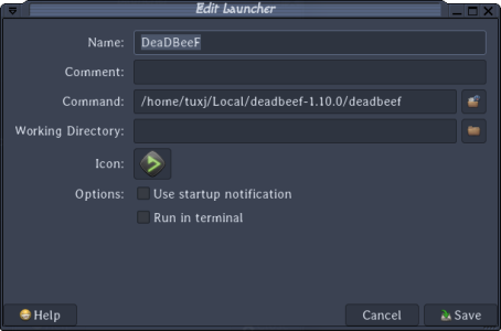

I'm not familiar with cinnamon, so I can't tell you exactly how to do it, but as a workaround, you can create a launcher, and give it the appropriate commands to launch steam, then put it somewhere.
This is in my top panel. It launches my music player from a directory in /home...
