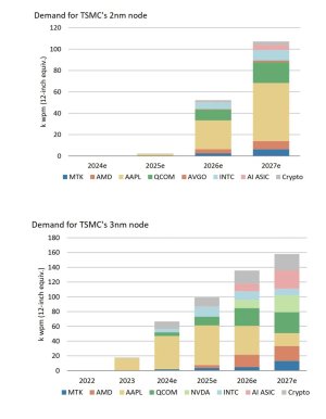

Looks like N2 is in full swing. Apple and Qualcomm have a huge chunk. The mobile market is so big lol
Interesting to see Intel use more N2 than AMD. So much for 18A...
Also, no N2 use from Nvidia, eh? I have to wonder what's going on with their chiplet development plans. At some point, they cannot keep slapping 600mm2 dies together and call it "chiplet" when it's more MCM. That and the reticle limit getting cut in half when High-NA EUV becomes the norm.
NVidia will be using N3P for Vera Rubin in 2026 while AMD will be on N2P with Mi400.
