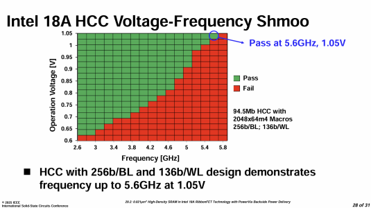

Could be could be not we will have 18A presentation in like 5-6 days at ISSCC.

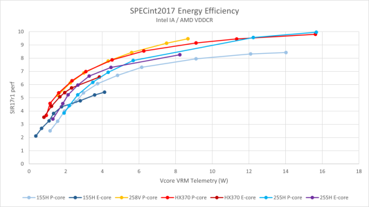

Nice prediction 🙂 I would take TechInsights Prediction than this one though as for low power characteristics even Intel 4(RWC) matches N3B (LNC)
Tock cores decrease or keep perf/watt at the low end of the curve usually. Knowing Intel, perf/watt prob decreased with LNC even iso node at the low end of the curve lol. Plus all that core private cache has to be pretty expensive to power on and take up a disproportionate percent of total core power at that end of the curve...
Intel themselves claims that Intel 3 is ~ TSMC N3E?P? in perf/watt.
I dislike Scotten Jones' method of calculating perf/watt. He assumes that 10 ESF is ~N7 perf/watt, inflating the perf/watt calculations of Intel's future nodes.
Same someone asked Scot he said he doesn't have a good reference for Performance/Watt in the semiwiki comment section

Ian is xeeting a bunch of slides. Going to be interesting looking through them all at the end of the day.
