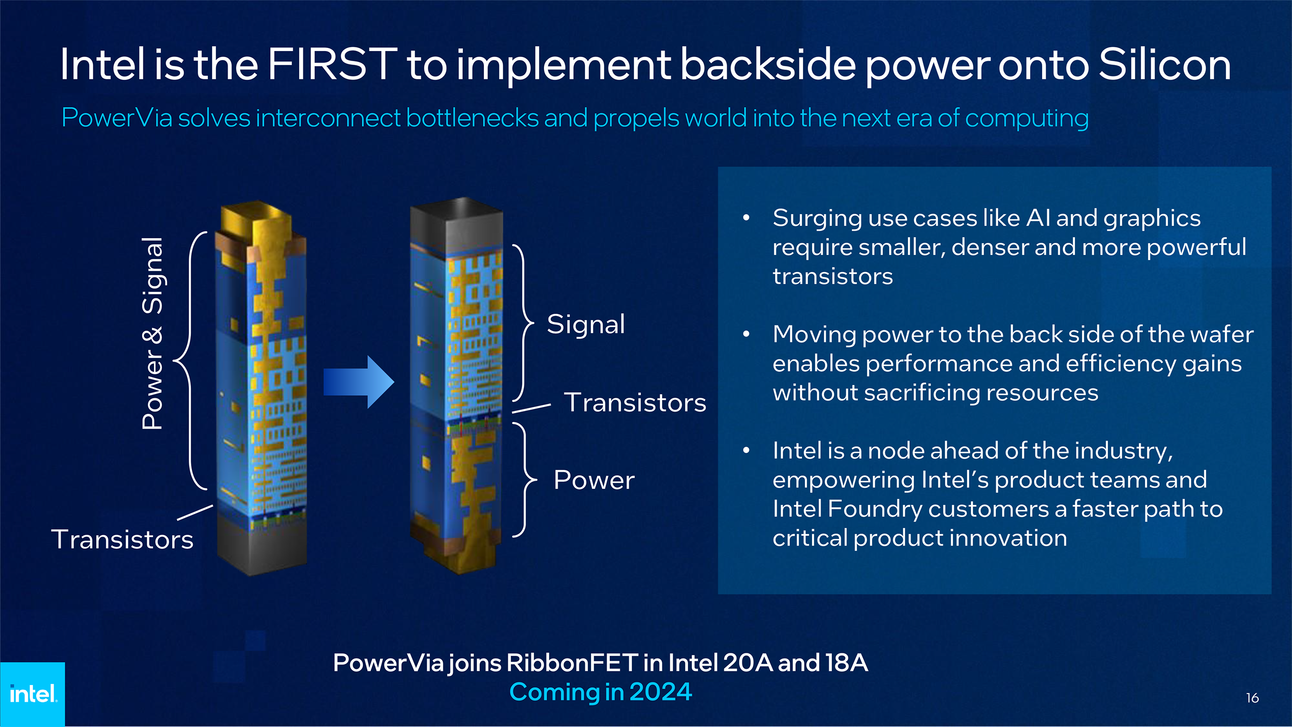

About the thermals of BSPDN/ PowerVia, Intel derisked this BPSDN technology with an internal node based Intel 4 test chip called Blue Sky Creek that was made on a Intel 4 + BPSDN. and had this to say about it
For instance, heat. “Normally you use the silicon side also for heat dissipation,” Sell explains. “So now you have sandwiched your transistors and the question is, ‘Do we have a thermal problem? Do we get a lot of local heating?’” At this point you can probably guess the answer: no.
Some unfortunate stuff at the end though!
As for PowerVia, it has no peer. According to recent reports, Intel’s planned 2024 introduction of PowerVia would put competitors “roughly two years behind” when it comes to backside power.
“At least for this time period,” confirms Sell, “we have a quite competitive backside power delivery option.”
Your first opportunity to feel the many benefits of PowerVia will come next year in the form of Arrow Lake, a next-generation Intel processor for PCs built using the Intel 20A process. Its billions of transistors will be inverted, working more efficiently than ever.

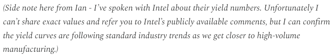

There is more information about this blue sky creek test chip in here (including a yield offset of 2Q for with & without BSPDN).
