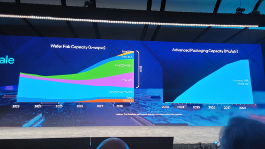

EUV shortage is still a thing for them. Unfortunately, they can't phase out Intel 3 early and repurpose the EUVs and other tools, cos it appears most of their products are set to use Intel 3 base tiles.
Makes me wonder, why do they even need Intel 3 base tiles? Why can't they use something like TSMC N6 base tiles that'll workout a lot cheaper and will also free up some of their EUVs for more advanced nodes. Compatibility issues with Foveros? Just sayin'.
This is too exaggerated. Intel7 is still operating in large quantities, turning off Intel3?

What about the Intel 16 capacity in USA it uses Industry standard EDA would be better than GF.
In case of war there will be a issues In supply chain for every company it's just Intel will take the least damage out of it's competitors.
Also in case of war Tsmc Arizona will be fought over by companies
