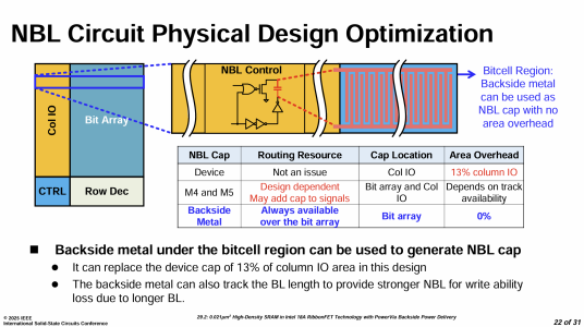

The density looks great, sure, but seeing as how SRAM density improvements have stagnated it’s not all surprising to me to see everyone at roughly the same spot on that aspect.

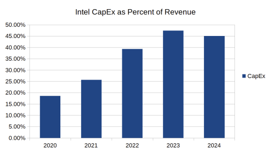

If you want to see why Pat was fired in visual terms, this is it (remember that Pat started as CEO in Feb 2021):
Pat was spending basically everything they could on building out fab capacity for IFS to be prepared to rival TSMC, or as Pat put it, "I've bet the whole company on 18a." Follow that by no major customer wins to speak of and multiple fab build-outs around the world being suspended, there was very little to show for all this spending. The only reason their cash flow wasn't worse, is that because they ran out of money and had to literally mortgage parts of their foundry's future for money to build-out their fab capacity.
There were, of course, other issues, but his almost tunnel vision focus on building IFS caused or exacerbated those other issues. He gave the foundry division an unlimited budget while making the design side change their operations to be more efficient. The need for greater efficiency on the design side was long overdue, but it just shows where his focus was in terms of spending and opportunity but it didn't work out like he expected, even though 18a seems to be shaping up to be a competitive node. The CEO is beholden to the board and the board is beholden to the share holders. Share holders speak in terms of money, not technology. Pat spent all the money while revenues dropped and seemingly had no intention of changing course. When enough time passed that he was forced to discuss the state of things, he could only promise the hope for profitability on his plan years into the future. That's why he was fired.
I just briefly looked through the slides shown, but I believe Intel also requires BSPD to get the last 10% to match TSMC's SRAM density. Obviously that's fine from a technology stand point as they should (at least according to them) have it ready to go this year, but from a customer perspective, many will not want to use BSPD due to the added costs and (maybe?) thermal issues.
Pretty sure they claimed the opposite, that Powervia increases area by 1.1x. Which slide or claim is it?
