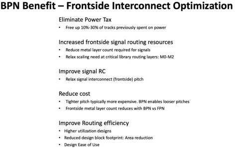

To me it seems more a branding move because TSMC is going to charge a lot more for A16.
Don't you think it will take more fab steps? First you do the power layers and data vias, then the transistors, finishing with the data pathways. I assume the data signals have to pass up through the through the power layers to the data fabric or vice versa. One of them have to pass through the other and assume the power will be the one closer to source.
Previously, you could lay the power and data paths in one set.

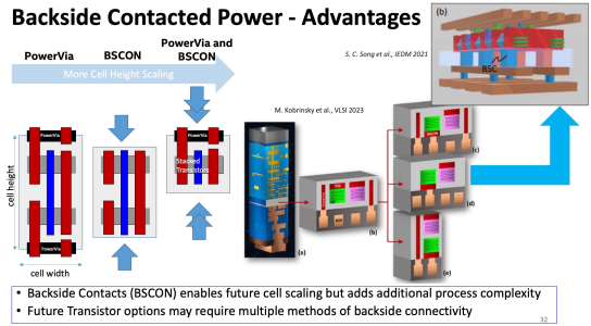

Intel 18A uses PowerVia BSPD, which is inferior to the Backside Contact BSPD that is used by TSMC A16.
https3A2F2Fsubstack-post-media.s3.amazonaws.com2Fpublic2Fimages2Fa5bcc073-dc67-4bfd-a443-6293b...png
Slide from:
I wonder, when will Intel upgrade to Backside Contact?

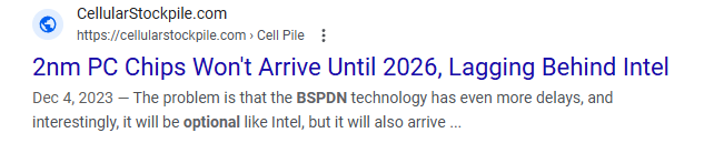

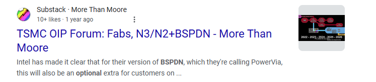

But as it stands if you want Intel 18A, it’s going to come with PowerVia whether you want it or not.
Where is this coming from, I'm not entirely sure since it's really hard to find information about this, but what little information I did find on the optionality of powervia on 18a seems to indicate customers can choose to produce chips on 18a without powervia.
It may well be the case that 18a is powervia only, but I fail to find any concrete information on that being true or not.

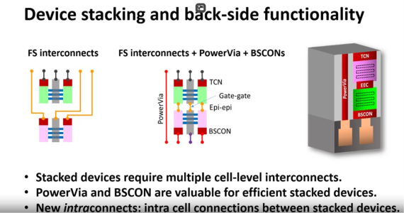

View attachment 112439View attachment 112440
I don’t have a definitive source, but every indication I’ve seen, including reading Intel PR statements, suggests that PowerVia is tied to 18A. PowerVia allows Intel to relax the pitch of the front side interconnect, so I surmise if there was some optionality to PowerVia, 18A would recess on density and thus no longer be the same node. Conversely, TSMC’s N2 and A16 appear to be sister nodes designed using the same pitch, which allows for the optionality of backside direct contact.

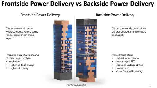

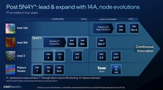

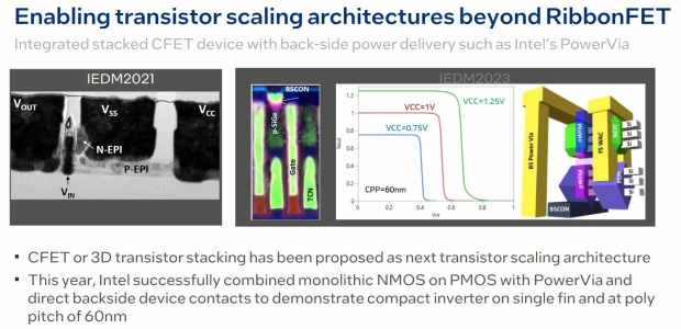

Regarding 18A:
Intel's recent research is shaping the future of transistor technology. By advancing 3D stacked CMOS transistors and backside power delivery methods like PowerVia, Intel is extending Moore’s Law well beyond current expectations. These innovations, closely tied to Intel 18A, are driving improvements in transistor density and power efficiency, ensuring Intel stays competitive in the high-performance computing space.
Source: https://semiwiki.com/forum/index.ph...ed-how-ribbonfet-boosts-ai-scalability.21352/

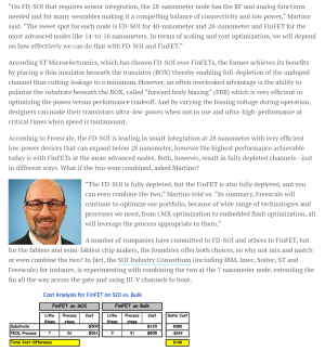

Dennard Scaling is probably more important than Moore Scaling.
FDSOI CMOS with dual backgate control for performance and power modulation, 2009, https://ieeexplore.ieee.org/document/5159302/
to
Unlimited Bi-directional Back-Bias in FD-SOI Technology With New Dual Isolation Integration, 2024, https://ieeexplore.ieee.org/document/10631338
Then, there is the domino circuit stuff: https://ieeexplore.ieee.org/document/10106142
"Nontraditional Design of Dynamic Logics Using FDSOI for Ultra-Efficient Computing"
Die #1 something like this: FD-SOI BiCMOS for logic
Die #2/#3 would be; standard FD-SOI for SRAM/eSRAM

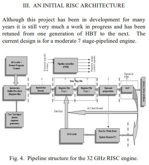

Boom, the gov can revive the Ultra High Clock Rate Computing(single core @ >32 GHz, OHPC -> UHPC) project from 2010. Since, that can't be done on FinFETs/GAAFETs since they abandoned Dennard Scaling.
Picture for the single-core 130nm BiCMOS -> 90nm BiCMOS product. Given bulk for 45nm PDSOI and 22nm FDSOI: https://ieeexplore.ieee.org/document/10732195 , with this being pushed to 12FDX from the Europe R&D. Which might rather use lateral BiCMOS on SOI (full SOI integration rather than Bulk-side) for the >1 THz Fmax/>700 GHz Ft grouping. Which is done by the US R&D side. STM-version: 'This work, for the first time, demonstrates an oscillation frequency fmax of 2.7 THz achievable by tuning the substrate bias in an asymmetric silicon-on-insulator (SOI) lateral SiGe HBT.' Regardless, yum bipolar digital applications.
