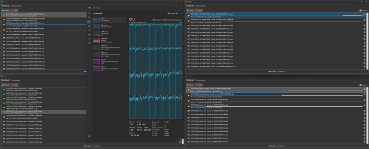

I wanted to chime in on this video encoding debate. I know I am a extreme minority here; It really interests me since it's something I hold dear, and I've been doing for a very long time, from ripping VHS tapes using a ATI All-in-wonder, to various Matrox gear, then DVD ripping and Bluray, to the modern day ripping 4K stream.
Handbrake can do multiple encodes within a single instance easily, so if you need MT maxed out, there you go. It can do whatever you want to do, just depends on your encode profile. You can mix and match CPU/GPU encoding if you so wish, with certain limitations. If you want to do mass encoding on a single machine, you're going to need a lot of RAM, surely for 4K you'll need that. A single 4K encode you're going to need something like 12-16GB per instance. Clock speed matters too (I think). I only say that because I never tested on anything higher than a 7950X. As evidenced by this thread, there are diminishing returns the more cores are added. Let me tell you cache also matters too. A 7950X3D machine I've got encodes some 15-20% faster FPS than a regular 7950X, despite a 200mhz or so clockspeed deficit. So to answer some questions, you don't need to run multiple Handbrake instances if you want to max out MT, just run more parallel encodes in the same instance. Handbrake allows you to do that.
Next comes my pure opinion. Anyone doing pure CPU video encoding is (mostly) out of their mind. We've come a long way with HW-based encoders. You can get amazing quality with GPU-based encoders. The only thing is the larger file size/bitrates. But still, it depends on your application and your intended uses. Are you doing VOD streaming and need the lowest bitrates and smallest filesizes? Maybe 5 or even 10 years ago. But these days when bandwidth and storage is so cheap, the disadvantages are non-existential. So what if I can encode a H264 to a VMAF of 93 @ 4000kbps, while a QSV can do the same at @ 6500kbps, what's the big deal? Speed is everything now. If I need to encode 4000 hours of video playback per day, guess what I'm going to choose? Definitely not the CPU. Back 20 years ago when the largest drives were 1TB, and most people had 10mbit, yeah, CPU meant a lot. Not anymore.
Now I want to end with a caveat. I still use CPU to encode all 480P/720P videos. GPUs are great, but they fail at lower resolutions. They're much more effecient at high res, like 1080P and 4K and that's what I use them for. I'll end by saying I only use Intel QSV and Nvidia NVENC. AMD is terrible, so if you're considering them, DON'T.
Just one machine with a 7950X and a Arc and NV GPU.

How do you know this?
I ran it on my 3900X and it didn't push the CPU to 100%, which is what would have happened had it split the source file into two parts, encoded, and then merged. And it should be obvious from any benchmark that it's not doing that.
