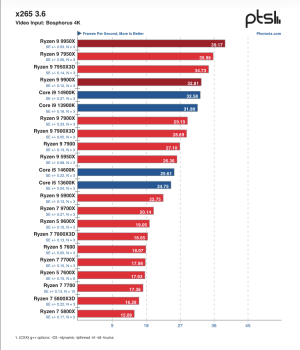

CPU encoding. Loves lots of cores.
Isn't handbrake known to crap out at around 32t before you get diminishing returns?
edit: looking at some reviews of 9900X and 9950X, it looks like x265 and (even moreso) x264 are not scaling that well past 12c/24t. Basically getting at best ~20% scaling from 33% extra cores, and it only gets worse from there.

@DrMrLordX:
The first test was from 2018. So the MT implementation in Handbrake and the underlying codec libraries may have improved since then.
Then regarding 9950X vs 9900X (and for the first test too), could the power constraint also not explain why performance does not scale linearly with core count in this case? I’m thinking that the 9950X cores will run at lower frequency than on 9900X, due to same TDP constraint and the former CPU having more cores so less power/core.

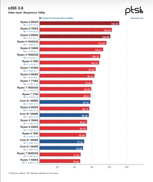

That’s probably 4K conversion as well. If you do 1080p or lower res, core scaling gets even worse.

So this is where fast cores are better than more cores?
Once you get past the 24ish thread count I mentioned, then yes, at least generally speaking. Just look at where the 5950x sits in these results. Twice the cores/threads of the 7700x but still loses to it.
If you bump up to 4K, things are different, but it still loses to a lower core count Zen 4 CPU. You can get different results with different settings and source videos, but the diminishing returns with large core counts holds true in pretty much every case.
