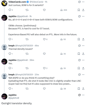

What would a top frequency oriented chip get at 115 W?
Depends on how well individual samples scale above a certain voltage. Possibly not well at all, meaning maybe 5150-5200 Mhz? Once you hit " the wall" on a process, the power/voltage requirements go parabolic, and if the transistor density issues are true then things get even worse.
