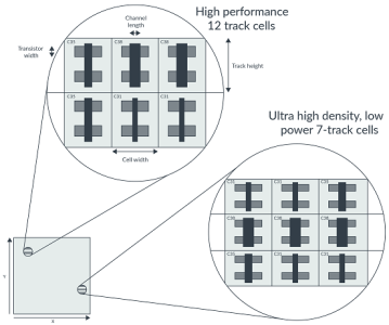

There are two effects and your post seems like you are ignoring one of them.
1) Yes, you can set different targets (like frequency). But that parameter will impact yields (parametric yield). You could insist that a chip be 200 MHz faster, and you might get some that do perform that way, but there will be very few chips that hit your high target and you'll have to sell a lot of lower performing chips at a lower price.
2) But another very important reason for high or low clocks is the node design rules themselves. You can design cells with wide traces and/or more traces (less electrical resistance), widely spaced apart (less heat concentration), and hit high frequencies. Or you can design cells with narrow traces and / or fewer traces (more electrical resistance), spaced closely together (concentrated hot spots), and hit a high cell density. These are two completely different optimizations for the same manufacturing equipment.
An example from ARM chips is below. In the same die area (which means the same ultimate cost to the manufacturer), you could have 6 high performance cells (high frequency) or 9 cells (high density but low frequency). The 6 cells can clock at a significantly higher frequency. But, the 9 cells lets you use a smaller total area and thus smaller price tag.
If the reason for lower clocks is #1, then you are correct. All companies can ramp up clock frequencies, to a limit, if they are willing to have low yields. But, if the reason for lower clocks is #2, then that is a massive design difference that takes millions of dollars and many months of time to change. In this case, the reason for the low clocks is extremely relevant.

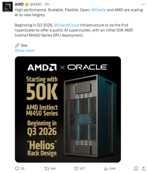

Its very likely that MI450 and Venice will be the first AMD products out of the 2nm production line. OpenAI and Oracle are waiting, desktop and mobile users unfortunately will take a back seat to that.
AMD just confirmed MI450 Helios racks (which include Venice) are coming Q3 next year. This almost certainly means everything else is coming after. Q4 '26 or later.
