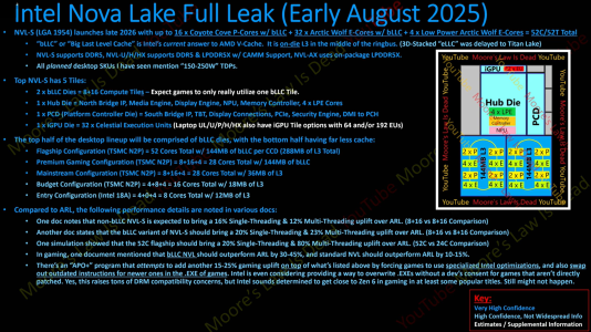

5.1Ghz fMax makes sense. It explains PTL-S cancelation.
And if 18AP can get fMax up to the high 5Ghz range, a lot of rumors are pointing at N2X being in the low 6Ghz range, again explaining why top NVL-S die will use N2, with mobile and lower desktop due on 18AP.

Joe NYC
Jun 26, 2021
3,655
5,199
8+16/8+16 bLLC - N2/N2P
4+8 -> N2P
4+0 -> 18AP
HUB -> 18A
iGPU Tile -> Xe3 reused from Panther Lake for desktop
edited some stuff
That's what MLID has as well. Except he has 4+0 as 18A, not 18AP
The the disaster, IMO, is that 4+8 and also 8+16 small L3 are all on TSMC. Those 2 dies are the bulk of the volume.
Also, taping out 4 separate CPU dies on 2 different process technologies just to serve the desktop segment does not seem very efficient, especially after all the job cuts.
Reactions: Thunder 57
511
Jul 12, 2024
4,565
4,189
Ehh the die is very well designed to make it 8+16/4+8/4+0 for the entire purpose here is the 8+16 die if you cut it in half it becomes 4+8 and if you cut that 4+8 in half ut becomes 4+0/8+0.
This is just for reference the layout has changed a bit in NVL but it's similar.
I expect to see 18A on the lower end desktop chips and perhaps a sizable amount of laptop chips. Nothing to back that up, just what I'm feeling.
And even worse, what if the 4+0 ends to be the better option considering the price? The bulk ends to be a BIG marketing dissaster at the end.
Geddagod
Dec 28, 2021
1,531
1,625
4+8 -> N2P
4+0 -> 18AP
HUB -> 18A
edited some stuff
Idk, I expect it to look like this (based on leaks I have seen, I could have missed some):
8+16 bLLC N2 (NVL)
8+16 N2 (NVL)
4+8 18A-P
I think it depends on how AMD segments Zen 6 mobile.
If only the AI 9 sku has the 12 core CCD, and the rest of the skus use just the IOD, a 4+8+4 Intel setup can be competitive with a 4+4+2 AMD setup. But also depends on how hard the AI 9 skus also get pushed, I think they top tier skus get pushed more in laptops than they do in desktop.
511
Jul 12, 2024
4,565
4,189
8+16 bLLC N2 (NVL)
8+16 N2 (NVL)
4+8 18A-P
Same but 4+8 got moved to N2P among cuts and plan changes after Tan he changed few things.
Even I got to know today lmfao anyway
Geddagod
Dec 28, 2021
1,531
1,625
Why though?
No way Intel has that little confidence in 18A-P.
Even if they think they couldn't get 18A-P out in time, making it on 18A likely won't necessitate any ports/changes since they should be IP compatible with each other, like Intel 3 and Intel 4 are.
There shouldn't be any Fmax concerns either since 18A already appears serviceable at north of 5GHz.
18A capacity should be ramping fast already since it should be out in products even earlier than TSMC N2. And they already invested a bunch of money into the buildout of 18A already, why delay or slow it down?
The only reason I can think of is that Intel wants to take the lead in the mid range laptop segment too. They might have a perf/watt or battery life advantage by using N2 there rather than AMD's N3. Perhaps I'm missing something.
511
Jul 12, 2024
4,565
4,189
Why though?
Ask Intel also Intel's 18A ramp capacity has been toned down from Initial estimates that's the only thing I know and the funny thing all the GPU Tiles are Intel lmao.
Even politicians are against Intel 🤣🤣. Imagine spending Billions in your country and getting problems in exchange.
Joe NYC
Jun 26, 2021
3,655
5,199
4+0 could be a better option than 4+8 if the clock speeds were nearly the same, but my guess is that the reason 4+8 is on TSMC N2 is because 18A does not reach the desired clock speeds, so 4+0 might be sold with lower clock speed specs
511
Jul 12, 2024
4,565
4,189
it's 18AP a '+' and Intel's plus traditionally fixed frequency issues Intel has another problem that is TRUMP is seeing Intel as a way to save his name in history so that he is treated as a hero Intel has become a political playground as well among other stuff
Tigerick
Apr 1, 2022
851
801
these are another SKU along with this
4+8 is fabbed by TSMC yes and it's basically 8+16 die cut in half
Hoho, I really hope you are not so naive about Intel roadmap. That past configuration might not valid: it might be combination of PTL and NVL:
NodeCPUGPUNPU
PTL-HIntel 18-A4 + 4 + 410 Xe (N3E)50
NVL-HN24 + 8 + 412 Xe (N3E)?
NVL-S Core Ultra 3N24 + 8 + 42 Xe (Intel 3)
Why do you think Intel rather use cut die of N2 to create low cost Ultra3 if 18-A is OK. As I said, 18-A sucks...that's only logical explanation.
Remember I told you PTL will experience many hiccups: cutting 4 e cores are actually worse than MTL's CPU. At least MTL shipped with full die of 6+8. To me, PTL pretty much is DOA, so much for process leadership... :p
